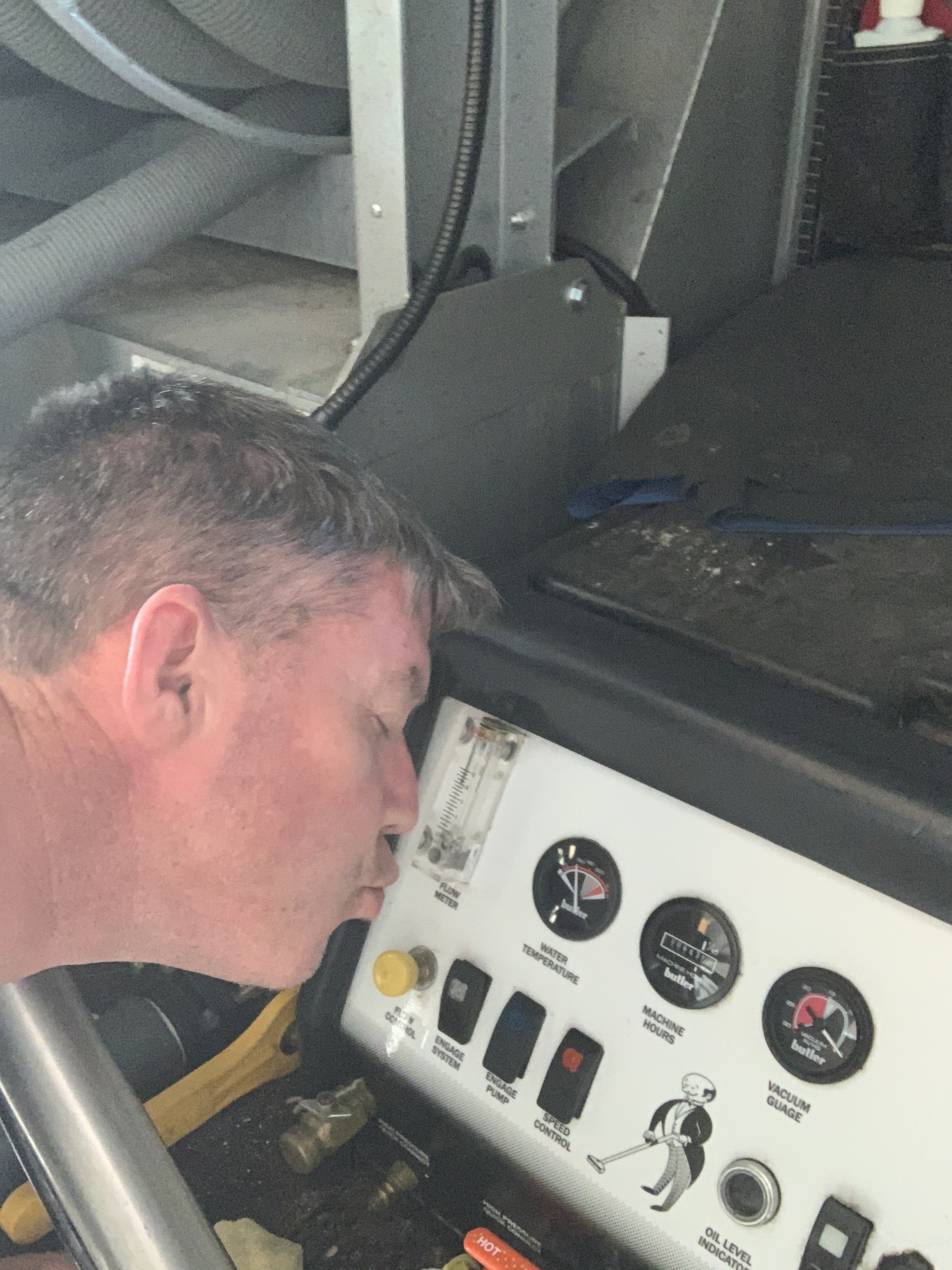

Every time I read these threads one of my Butlers gets a wet and sloppy

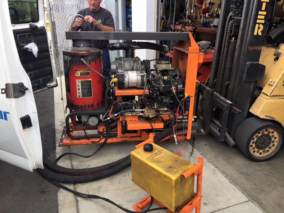

We are looking at a Butler that had it's hx removed and replaced with a burner system...why in the world? If we get it we have a couple of Graham HX to put back.
I can see why they did it honestly. I would never order a Butler without the MAX Heat... doesn’t maintain above 180 without it , and in winters it drops even lower depending on flow
drop In the HX but you may want to keep the burner when necessary
