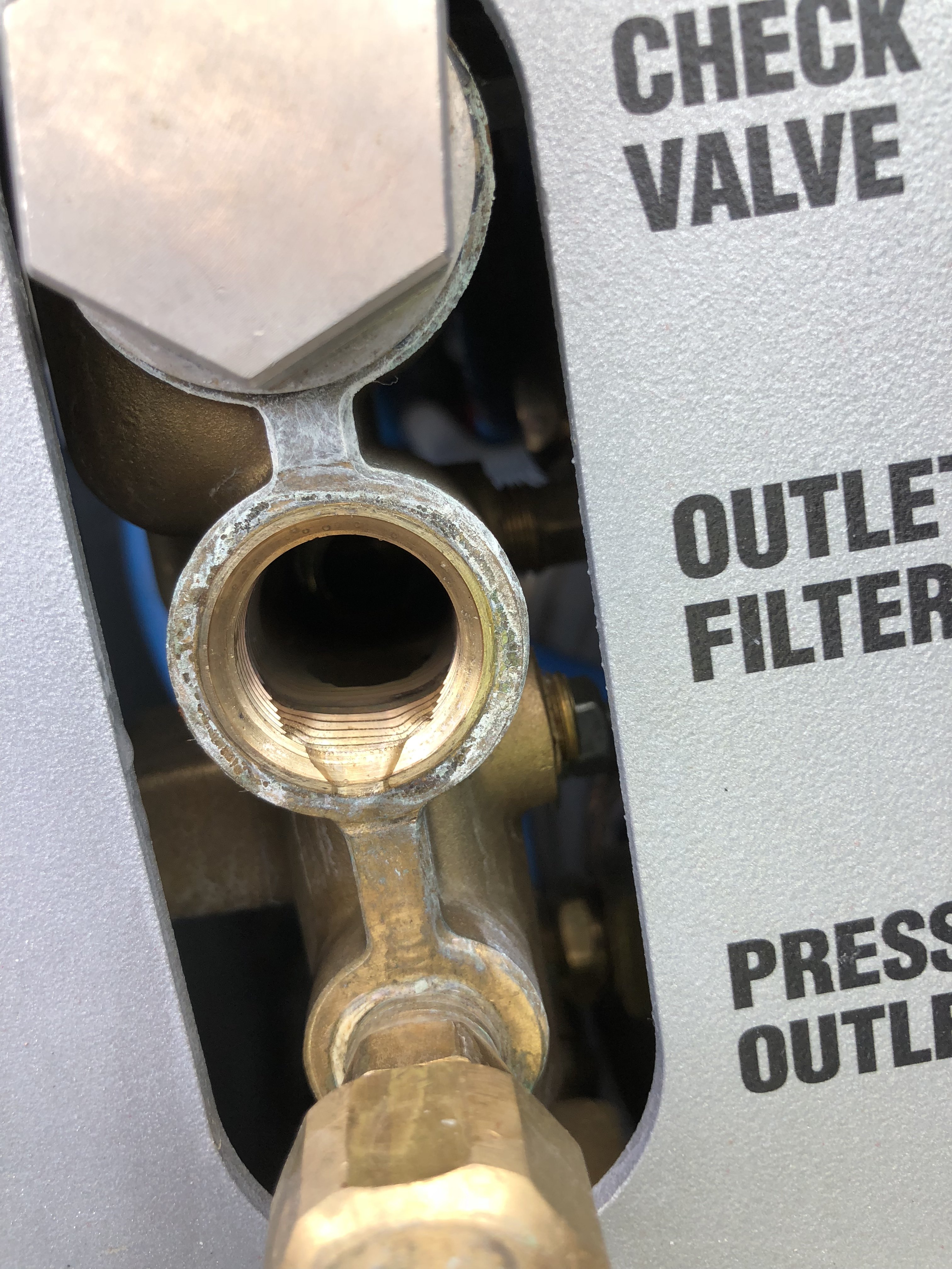

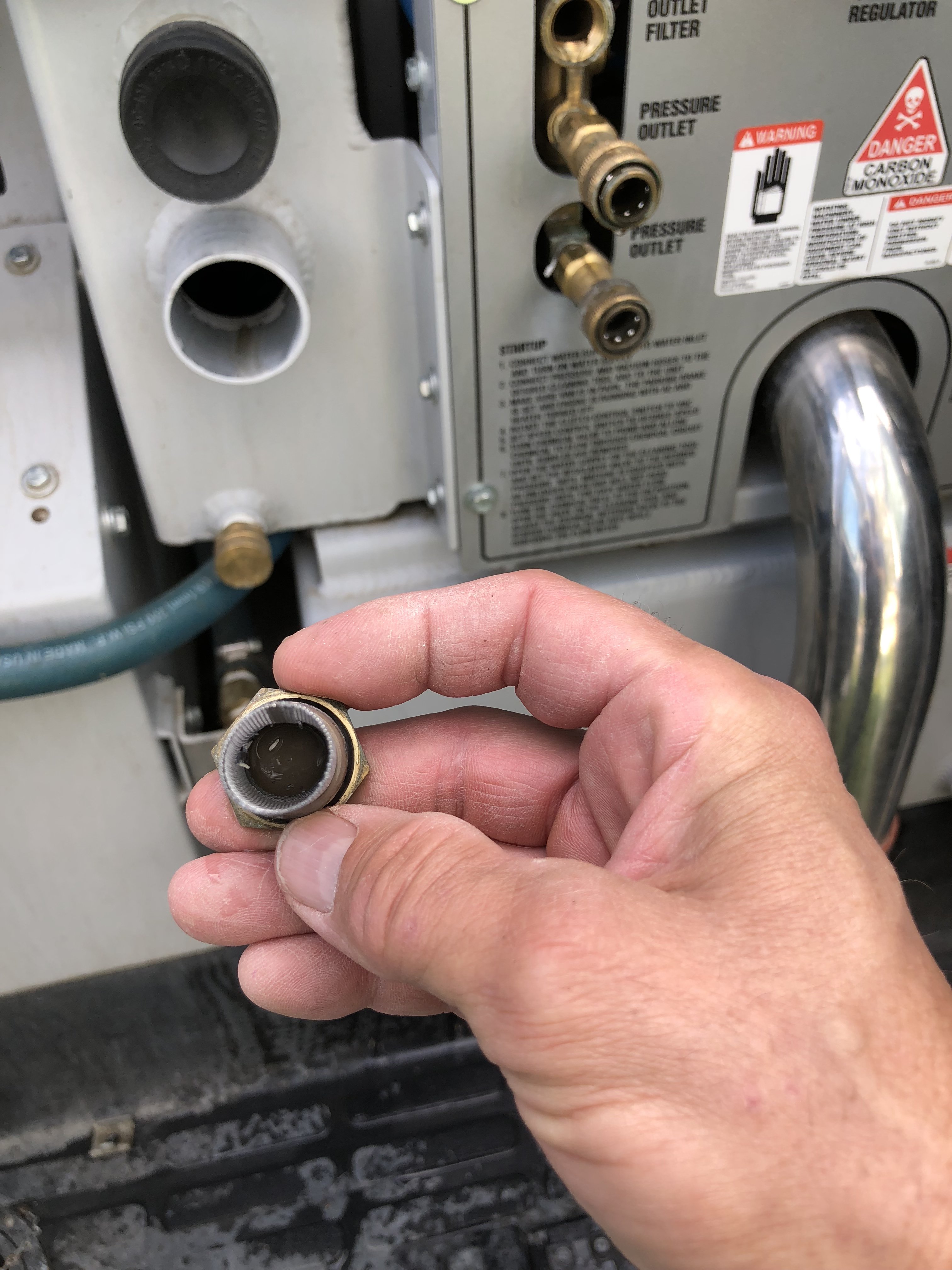

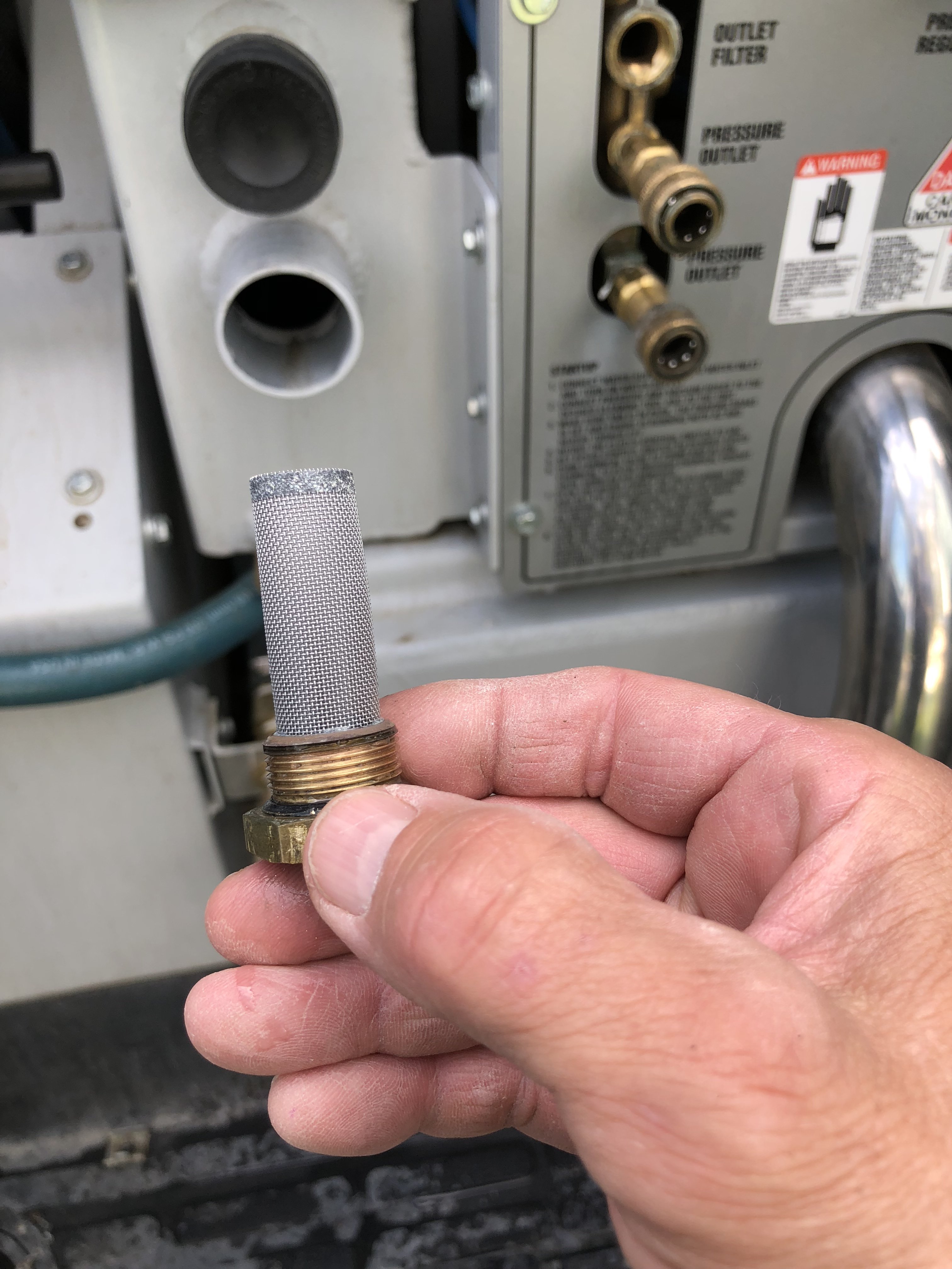

I know there Saiger videos for butler!
But does butler wave a water box to add the descaler?
The pro 1200 has no water box !
I know the 570’s water box with the radiator pressure relief cap you lower the water put a gallon or two in the machine and use a loop hose from the intake to the water pressure out!
And kinda sprinkle the descaler into the water box slowly.
Let it run 15 minutes and flush with water 5 minutes and detergent another 3 minutes!
So I’m wondering do you use the chemical jug and use a loop hose on a pro1200?
And just meter it at 10 and let it loop?
