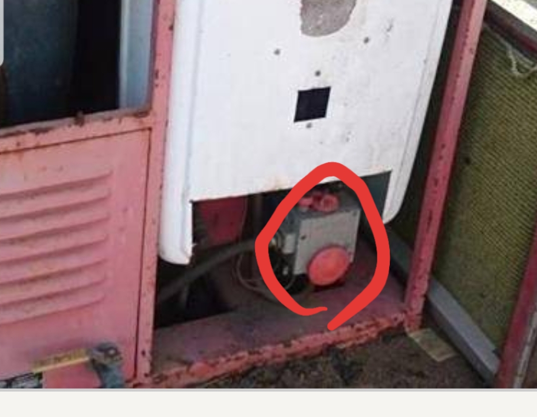

Hydracat truck mount. They used them in welders as well. No pics but looks pretty much like Shanes.
27,969
hows that work with the unitrol down there?
The way it worked with the thermostat at the bottom of the coil, is that the burner would fire when the water in the entire coil dropped below a certain temperature. The new ones with the thermostat at the top cause the burner to fire as soon as the wand is triggered and cold water enters the system. Under the old system, you would get high temperature spikes, then it would drop off and build again. With the new thermostat at the top, the temperature is more consistant. The new ones don't go over 230 degrees f. unless you play with them. The old ones could build temps up to 300 degrees f.
I wondered if that was an original configuration. Because it never made sense to me when hearing of heat spikes in a LG
My Dads 1st LG has got to be 25+ yrs old and has the thermostat at the top, if it heat spikes you know the thermostat has gone
27,969
Some of the first truck mounts I worked on had the thermostats on the bottom. They would get so hot, nothing but Steam would come out. Had to hold the trigger open until it would cool down enough to clean with.

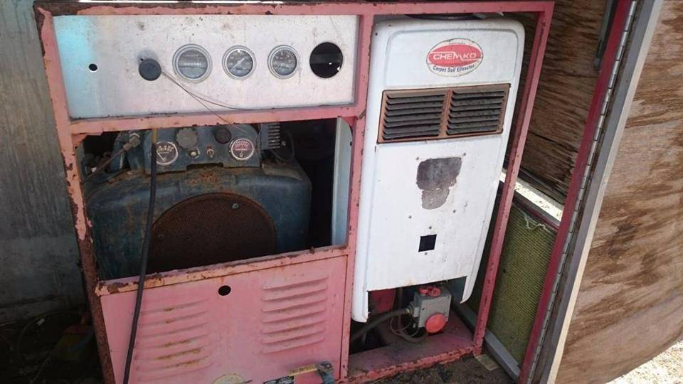

I still have the original Turbo Tech brochure. I purchased it used in 1987. Mine was the Commander, it had the 20 horse Onan, #4 Suterbuilt, Cat 290 and 110 gallon aluminum recovery tank. The only thing that is still original is the frame and Stoddard silencer.
Sorry the attachment isn't very clear.
