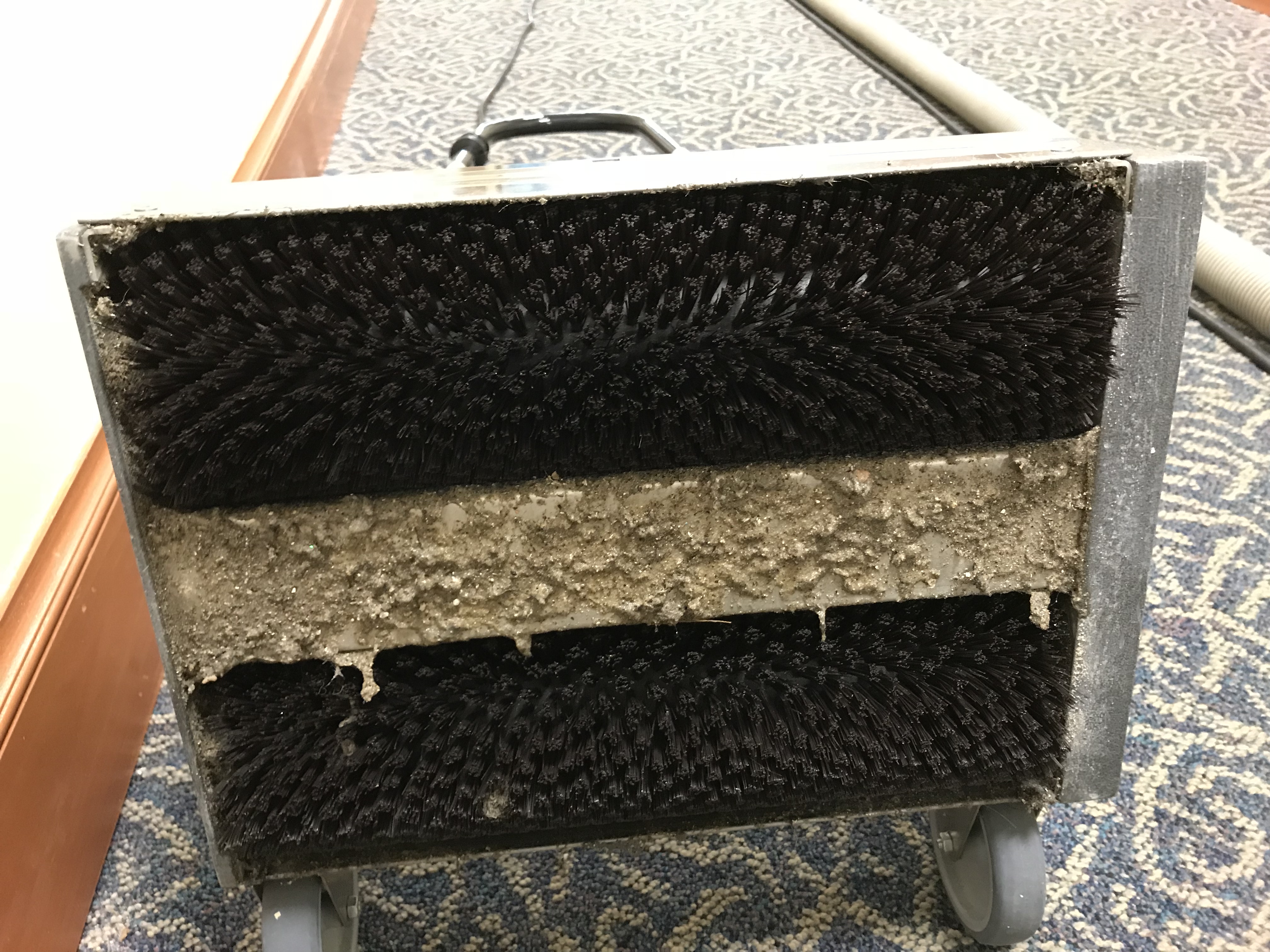

Tell your guys not to park the brushes straight on the van's floor. They sure look like they are getting flattened. Chapter 11 paragraph 57, SS- employee manual.

Do you use the black brushes on everything?
These are the commercial Brown brushes probably in the video. They are a stiffer brush over the white brushes for this unit which are considered standard. We use the brown brushes a lot because we see so much polyester where we are at. We get into something nicer like a nylon we switch out to the white brushes. We do have black brushes for wool but I've only used them a few times. The black brushes for this unit are very soft by the way
