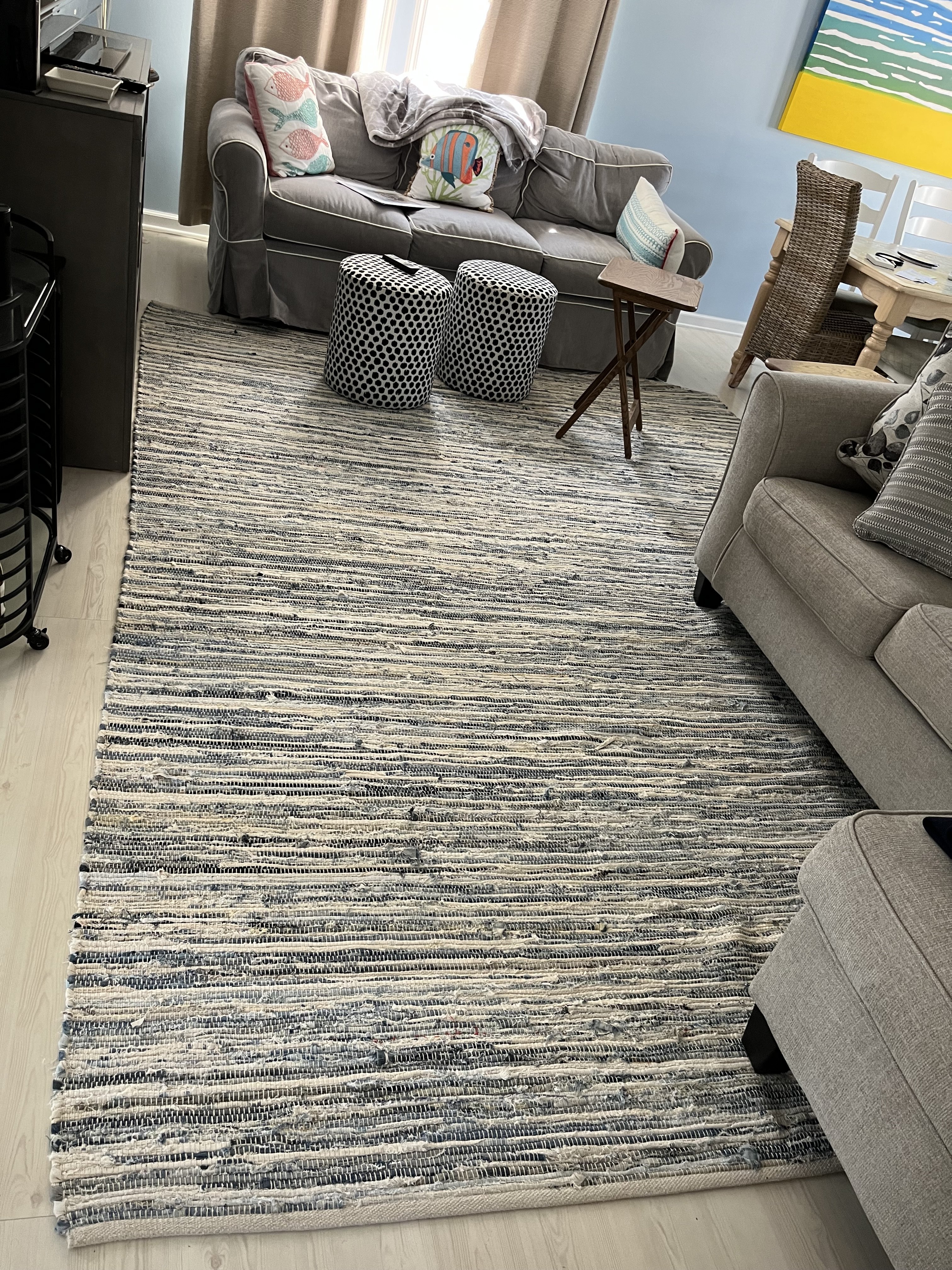

Got a pic of an area rug from a new potential customer.
Not used to doing this by picture, I usually like to see it in person, but incorporated this pic thing recently.
Would y0u schedule this for an in house cleaning? Im thinking $125, easy.
12,673
Browning is in your future if you HWE that with a wand
116,388
It would be highly entertaining if you cleaned THAT! with TOPSPOT...
This is one if those situations where 1.0 would say " if you have to ask, DON'T TOUCH IT"
3.0 says find a real rug shop and pay real close attention to the rug portion of our class in 2.5 weeks....
Reactions: Mike J

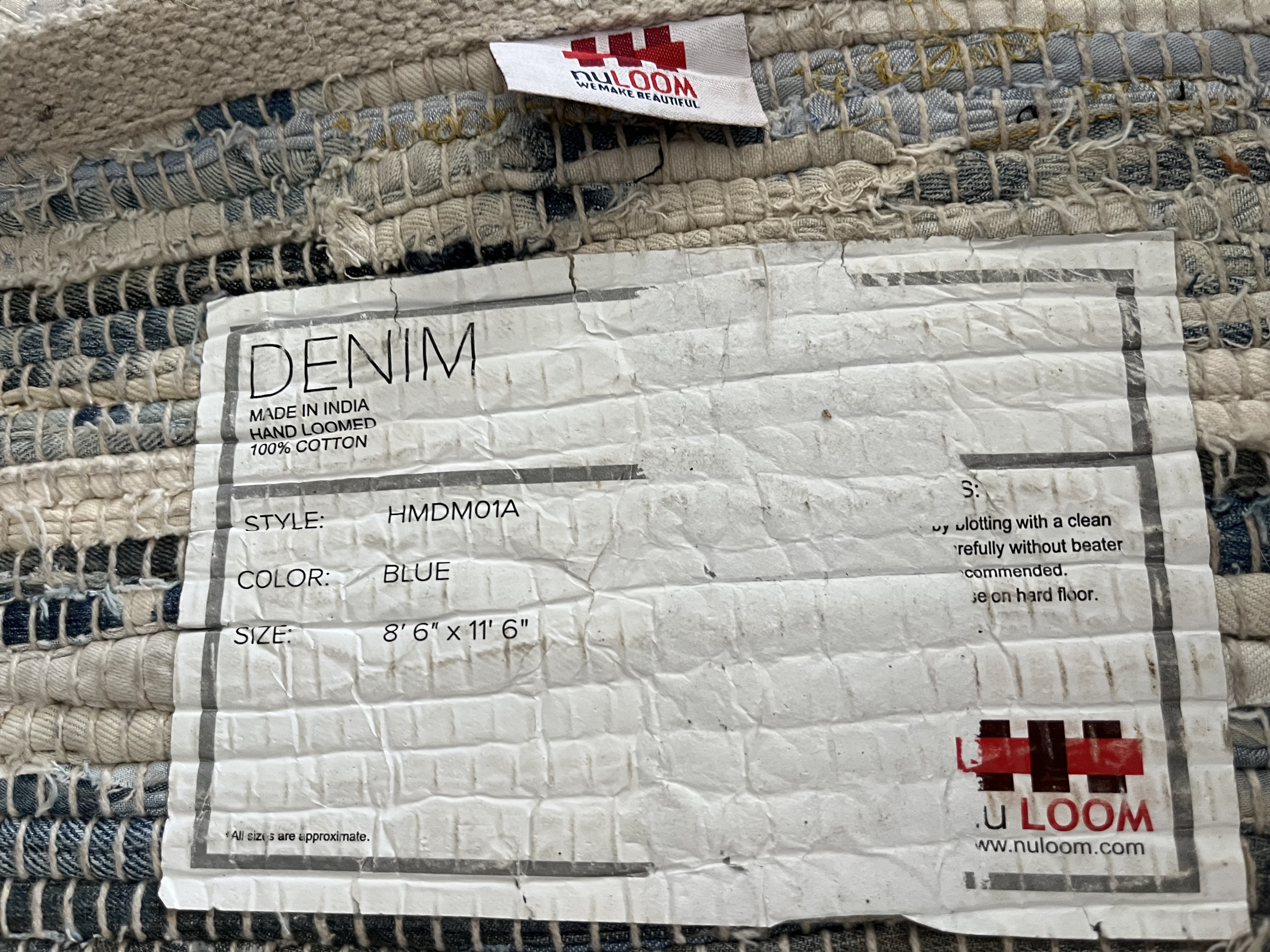

Cleaning in shop HWE is best bet, after letting customer know the colors may bleed a little.
Reactions: Mike J
Mar 29, 2008
9,605
Hawaii
Nate W.
Denim on upholstery or rugs is not the smartest thing to purchase.. You can clean it, but I wouldn't attempt on-location..
It will get lighter and possibly move the darker colors to the lighter colors..
Reactions: KevinL and Mike J

I replied with the risks mentioned, recommended rug washer, and not on site. Told her for $125 I would give it a cleaning after October, probably in the winter if she didnt care and just wanted to try knowing the risks. Pick up and drop off. Easier than digging clams.
