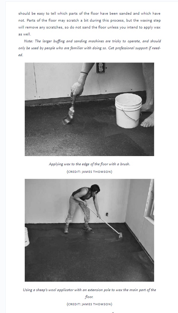

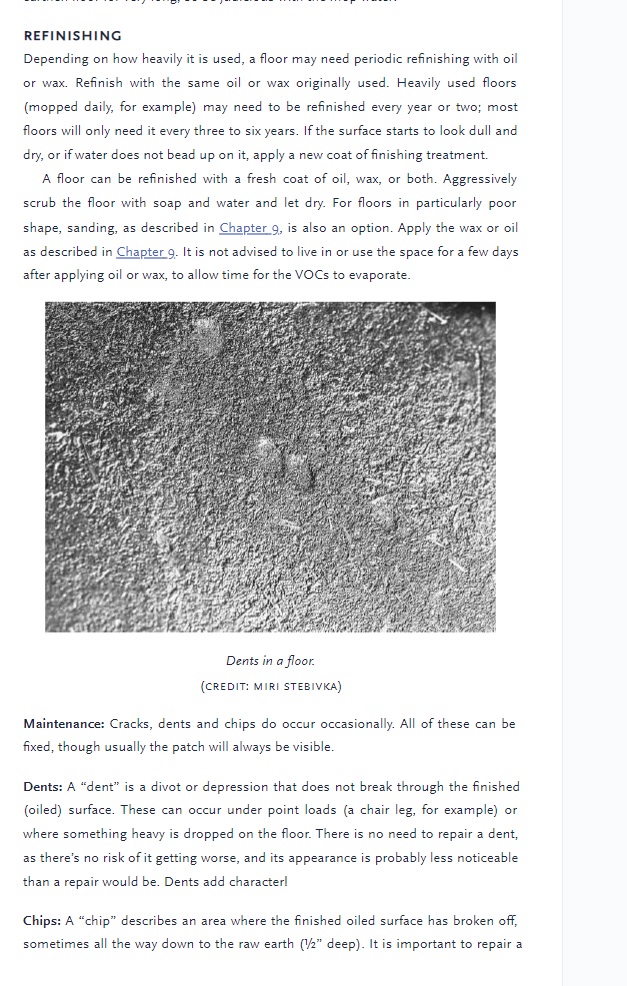

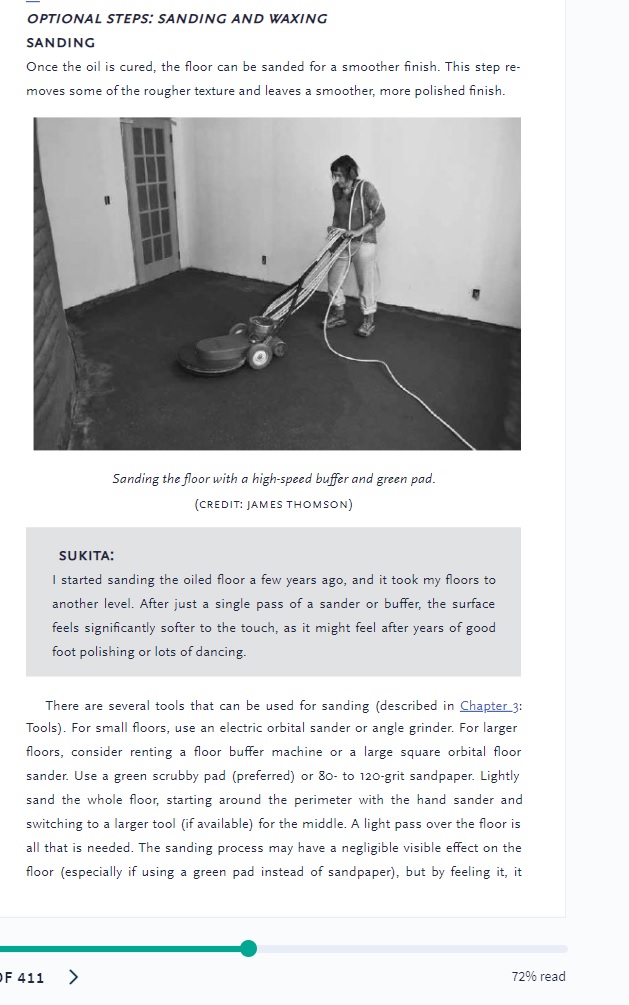

The property i was in at Oregon was a cobhouse. My wife mom has that floor. She sand and reapply wax. She does it by hand because it offgrid and the solor power isnt enough to operat 175
DAT
Apr 3, 2017
6,487
Bill Cheryl
Correction, i believe she only used linseed oil
so it looks like
scrub with soap/water (maybe a little dlime)
re-oil (?) and let cure
sand with green pad or 80-120 grit sandpaper
Apply new wax coat
buff with a white pad
*I'd be curious if the "sand it down smooth" is to correct problems that are better corrected by other methods or even a complete redo or just to give a more polished texture
