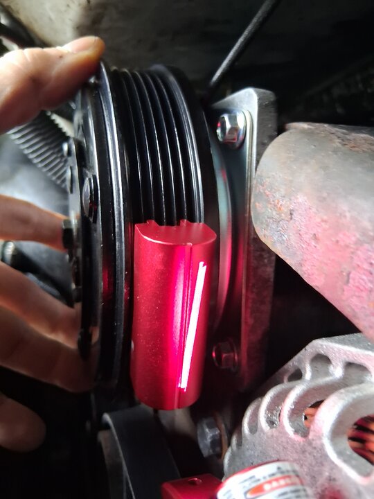

clutch pulley alignment
scotty747
Oct 19, 2006
920
I calibrated the Lazer and stuck it right on so I didnt knock it out of alignment. Looks like the top of the pulley needs to move back. Do I do that by adjusting the shaft?

When i installed frankinstien i had to fabricate a rear mount from cleanco parts to allow me to raise and lower and move right or left the machine end of the driveshaft to align

Somehow your clutch needs to be tilted up to make the target and laser lines parallel once they are parallel then adjusted in or out till target and laser lines are together

Maybe this wording will help. The laser is showing you how the clutch needs move and to angle to align parallel to the alternator
