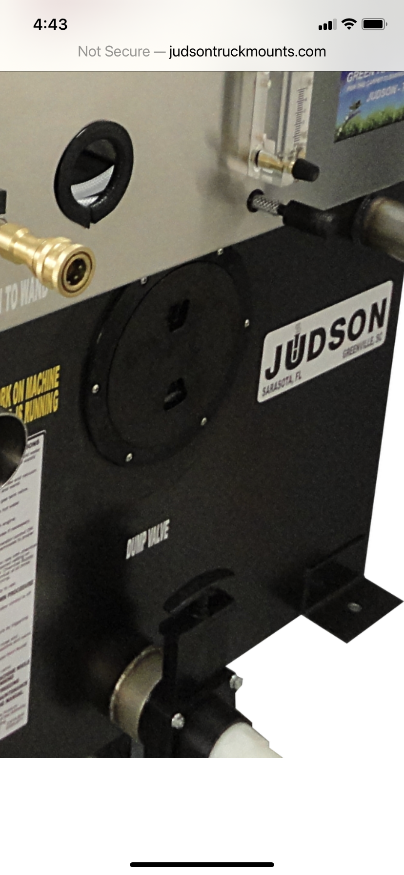

Jun 3, 2021 #1 I ImperialCC Member Joined Apr 11, 2021 Messages 126 Location Gaffney, SC Name Jason McCurry Any suggestions on how to remove the black cover on the waste tank?
Jun 3, 2021 #2 F FB19087 Guest pin spanner wrench, deck plate key, wood and a rubber mallet you can also drive two lag bolts into a piece of 2x4
Jun 3, 2021 #4 The Great Oz Member Joined Nov 25, 2006 Messages 5,292 Location seattle Name bryan Thumb and forefinger in the holes, twist anti-clockwise and the inner plate unscrews.
