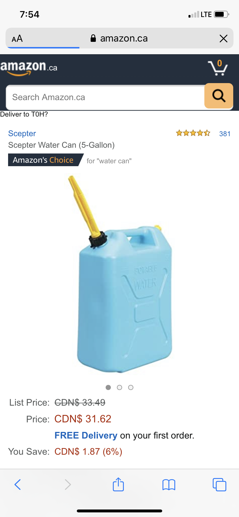

These... get a heavy duty trolley/cart, and prefill the jugs MIXED with the chemistry. Then, all you do is drop them randomly throughout the job with a change of pads, and production increases...
I just picked up a large contract, done quarterly, it’s close to 25K sqft. That’s the system I run, I find I can make between 3-500$ an hr....

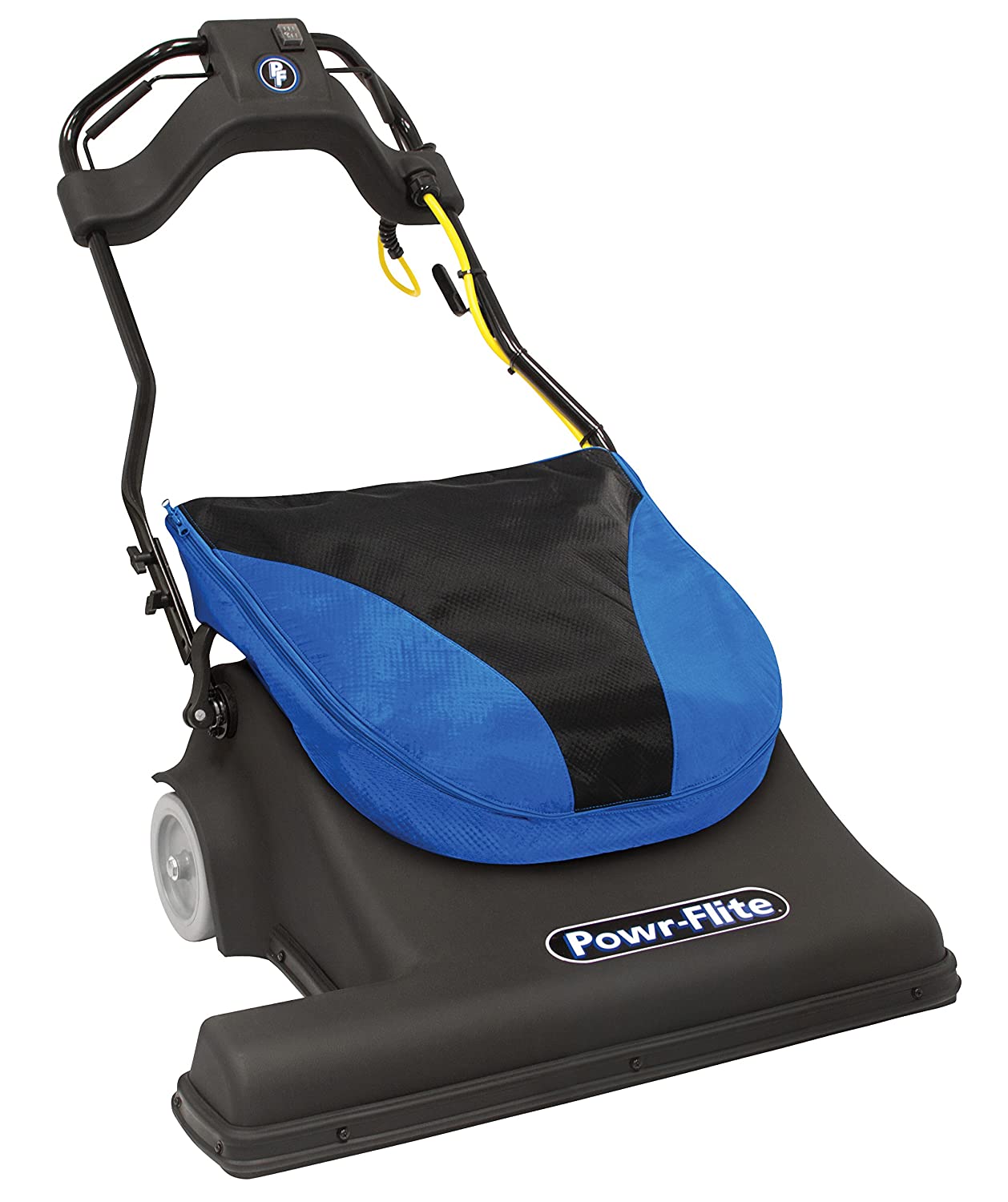

thoughts about buying one of these vs putting more man power on more regular upright vacuums
Jun 20, 2016
6,564
Jeff T
Unless you are cleaning football field size open area, it would be useless. Most commercial is offices, cubicles, and normal width hallways. You need a 12”, a 15 or 18”... AND a backpack vac..... I almost never use my 18....
Think of VLM as a system. Yes, you can just plow through with the Cimex, but prevacing is what’s going to get you back in the door 3-12 months later....

I believe that vacuum is more a top debris vac. You do need a large area vacuum like a 28, but it needs to be a sure enough vacuum. I use an old Clarke upright that you push with two hands, but it’s a beast and heavy. Matches my Cimex😀 Still need a regular upright too.

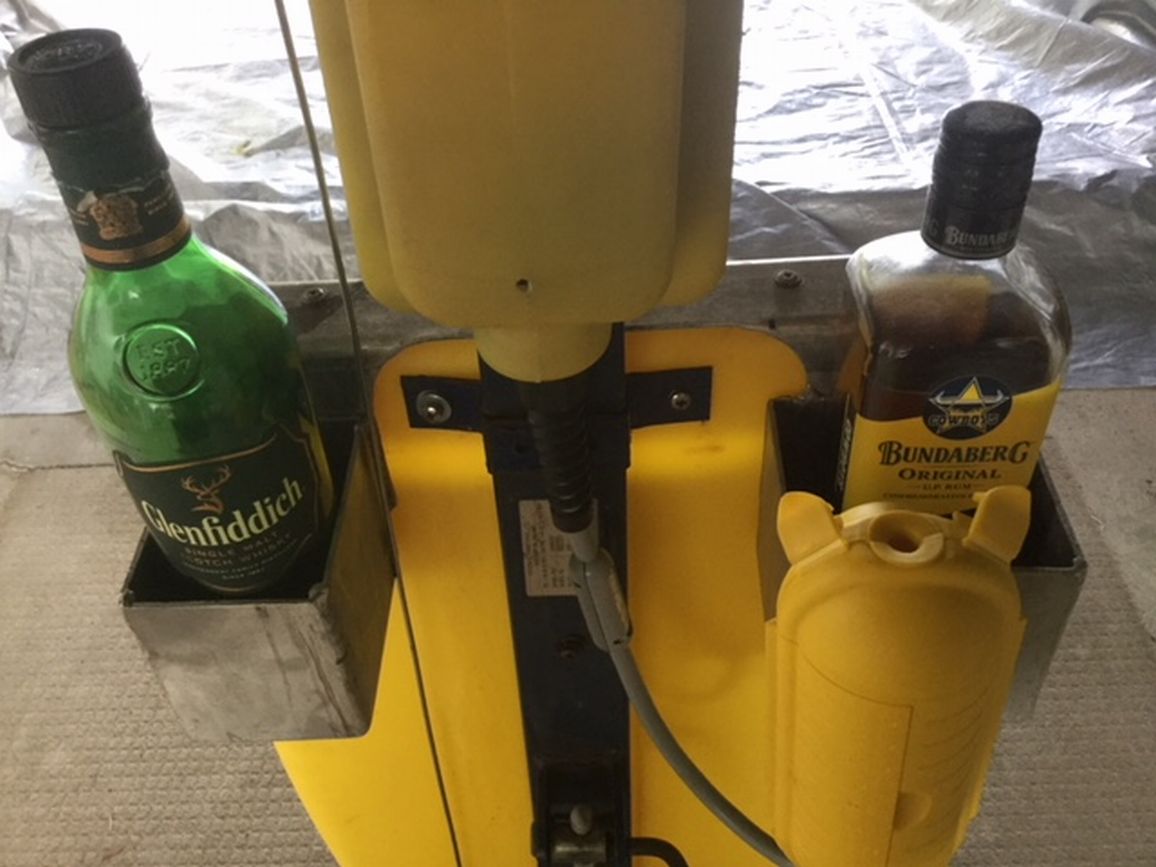

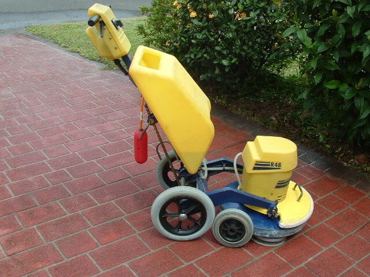

Shorty
RIP
Nov 8, 2006
5,111
Shorty Glanville
one thing to think about is the wheel upgrade for the cymex I have one with and one with out I use the one with the bigger wheels .
It handles a lot nicer its worth the couple hundred bucks in my opinion but also not a must have .I want harly grips for mine lol.
Mine has both.
Pic of the Big Wheels was taken in January 2008.
:yoda::very_drunk:

Mr.cleansalot
Jul 22, 2020
63
JAMES FISHER
Your cymex looks different then mine mine do not have the plastic cover .
Is that a upgrade ?
