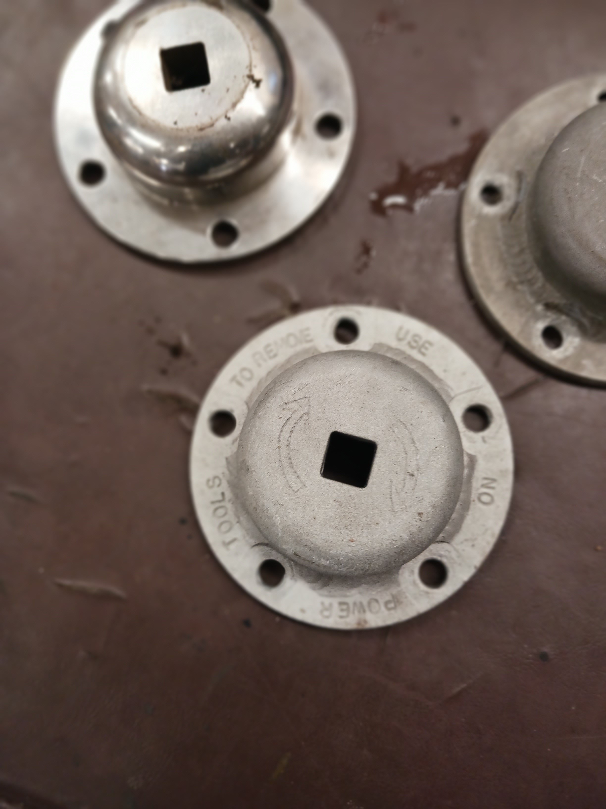

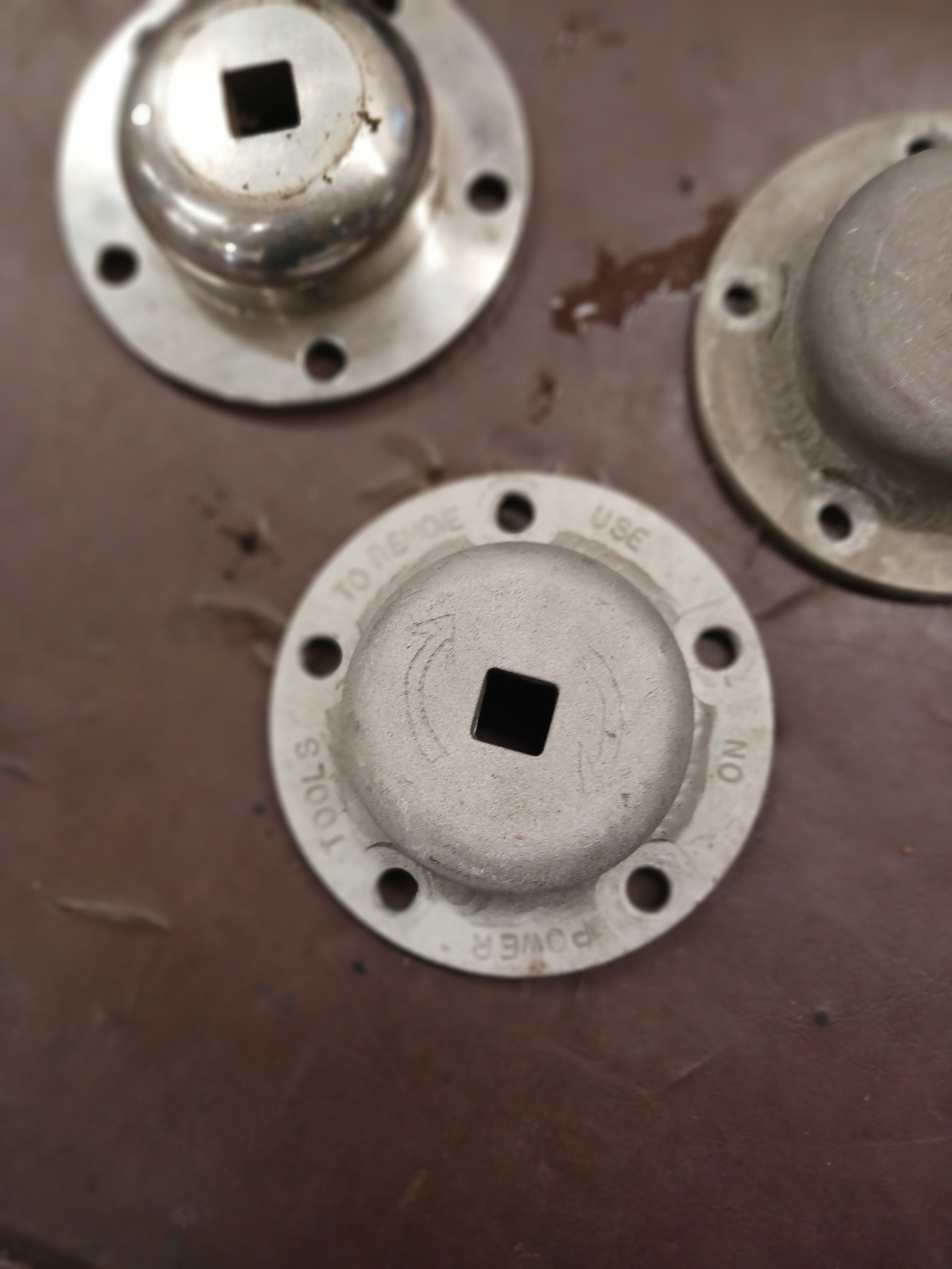

Can you guess what this was used for?
Dwain Ray
Jul 22, 2020
344

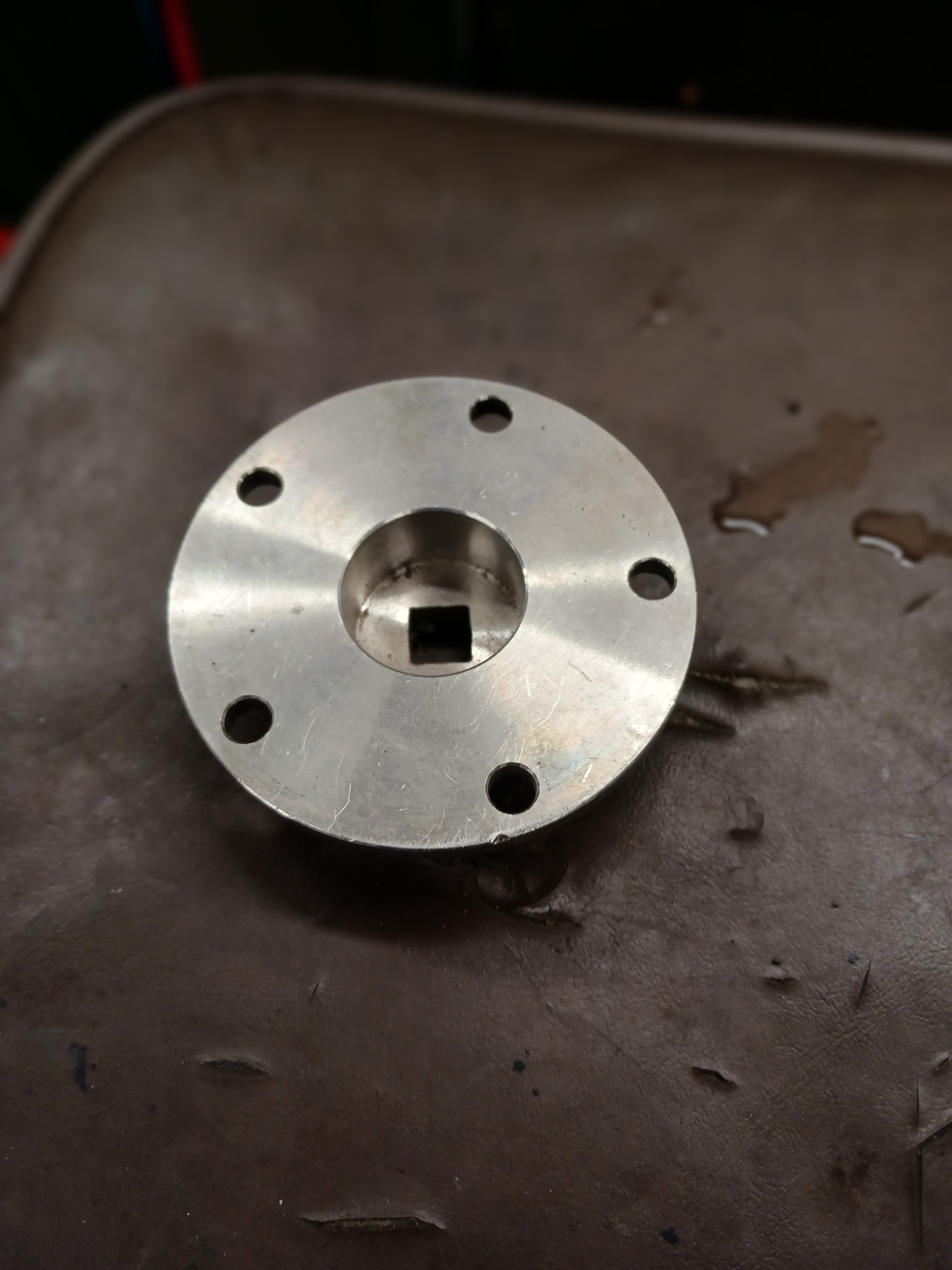

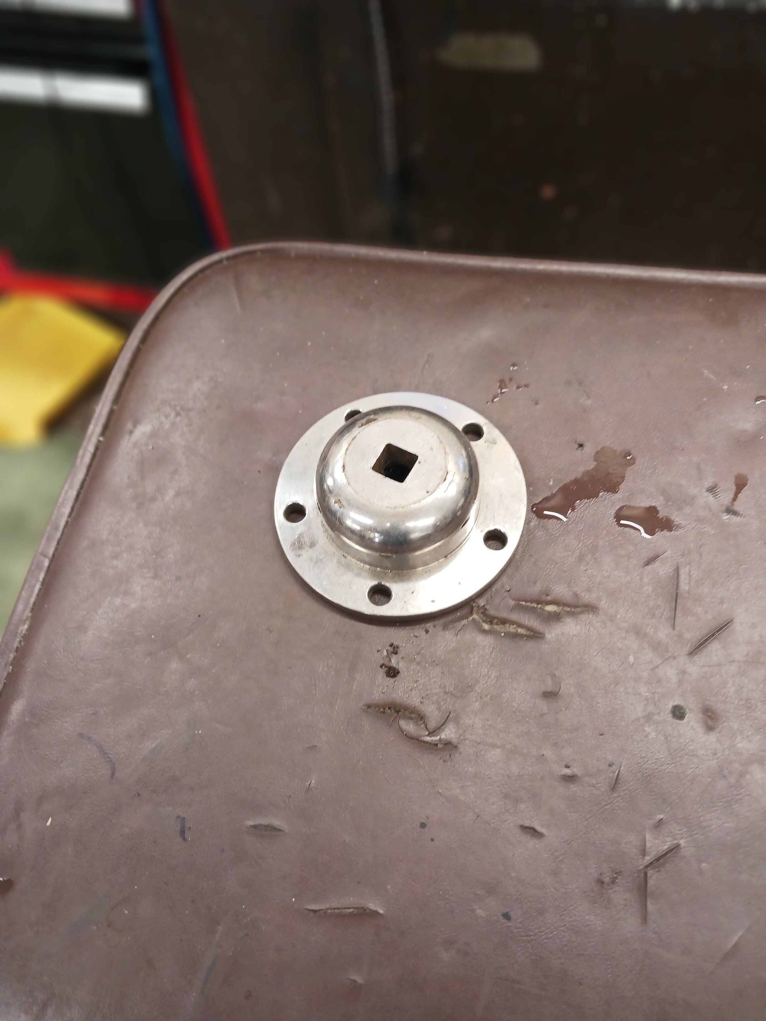

I made these awhile back to fix a problem alot of us had but before it went to market the problem was solved can you guess what they were used for? Careful your about to show your age!
idk...is it for a fan clutch?
I'd guess a puller of some sort but for the ratchet sized square hole
Dwain Ray
Jul 22, 2020
344
To remove a stuck star.
We have a winner 🏆 🥇 the early low speed rx20's had a single lead thread and as you used the rotary the star got tighter and tighter and alot of times it would be on so tight you'd snap off a head trying to kick it off, i called this a hubcap it allowed me to use a breaker bar to remove it. Fortunately for us but unfortunately for me ,hydramaster went to a double lead thread and eliminated the problem i made 2 aluminum prototypes and 3 stainless

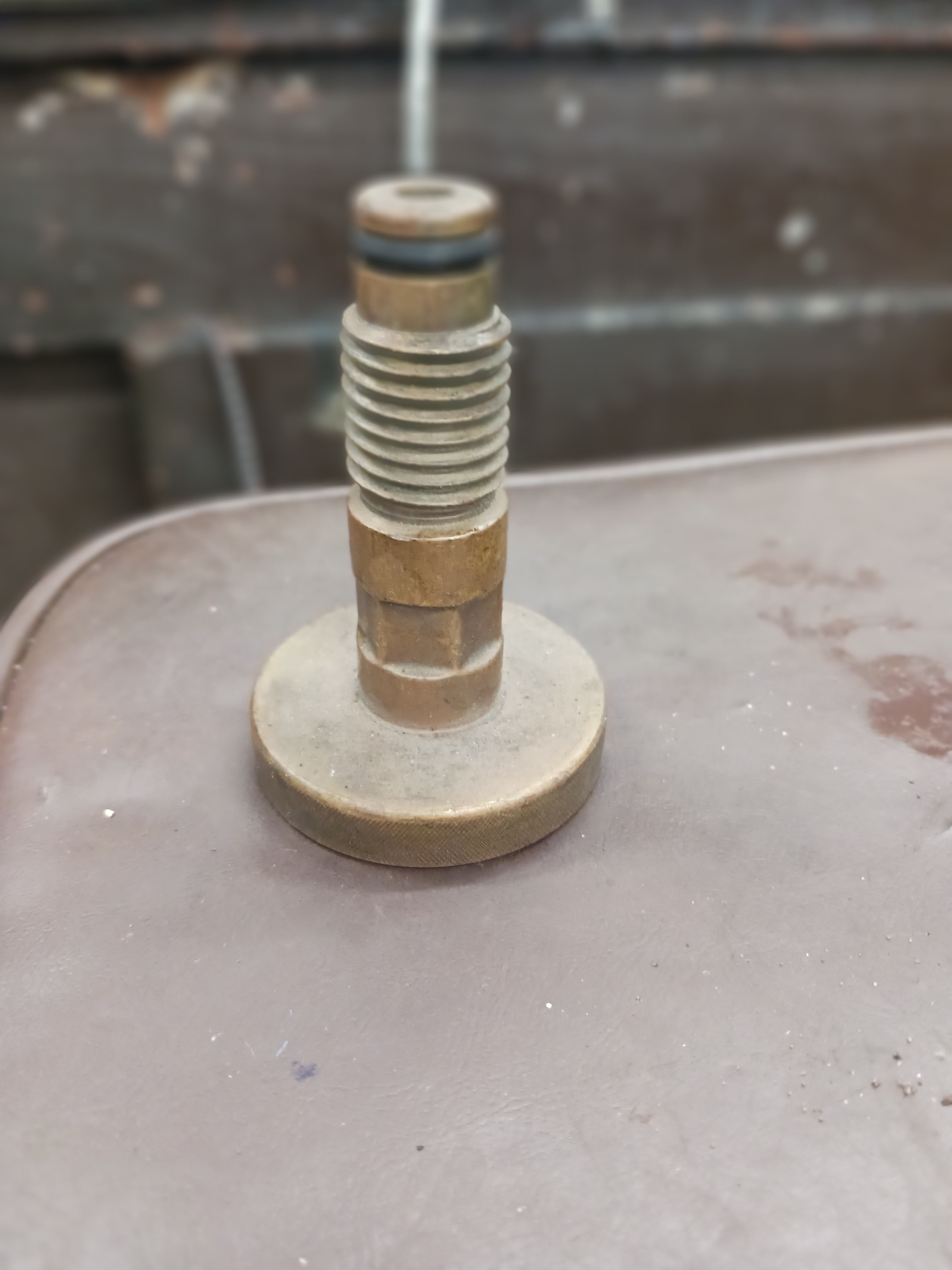

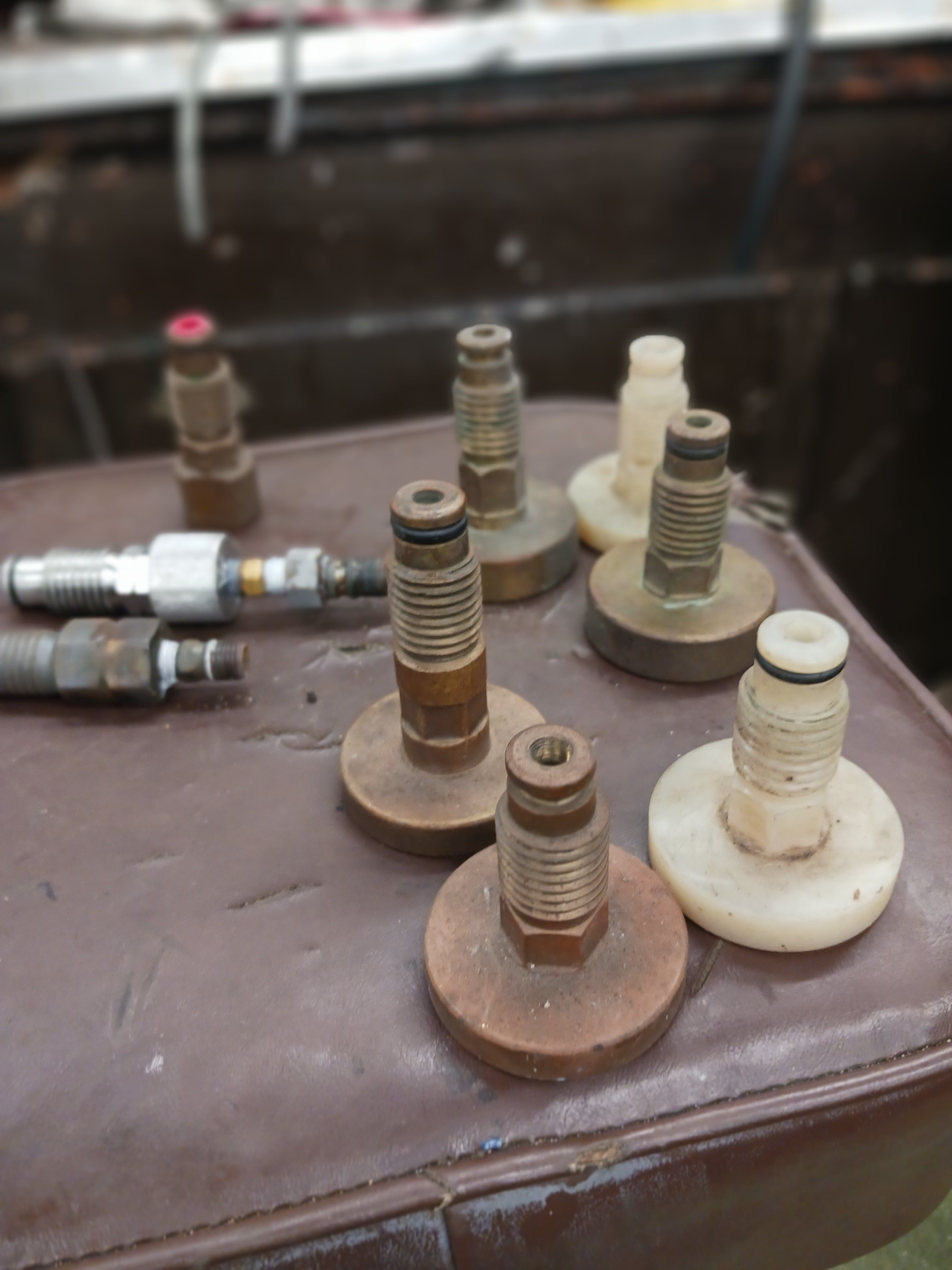

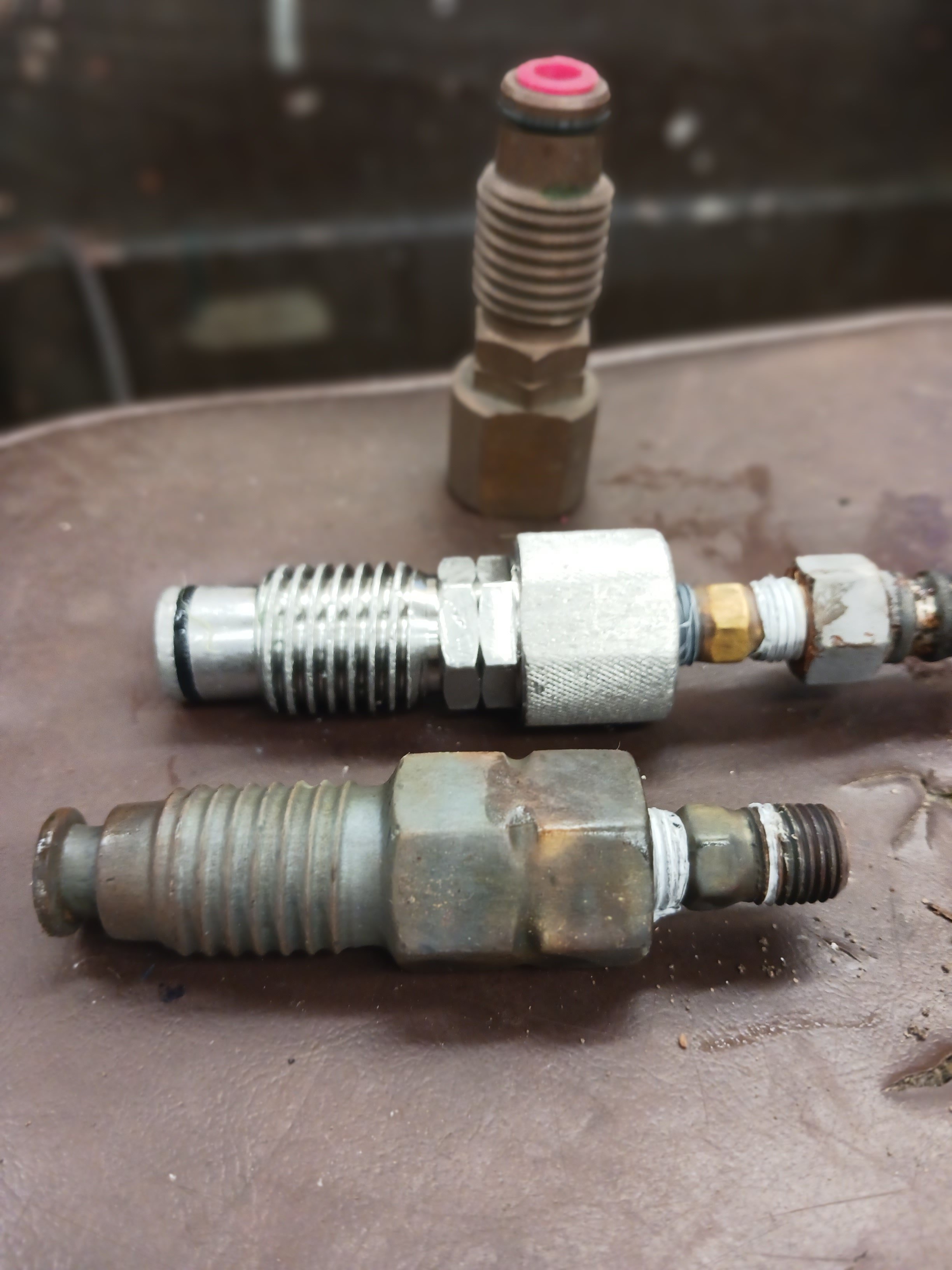

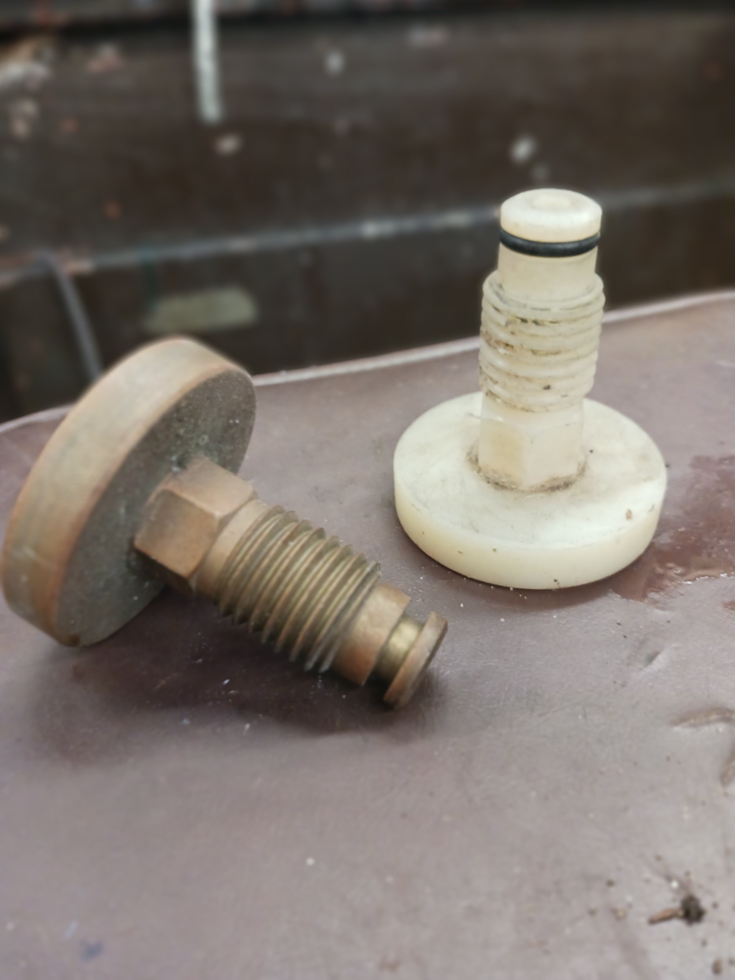

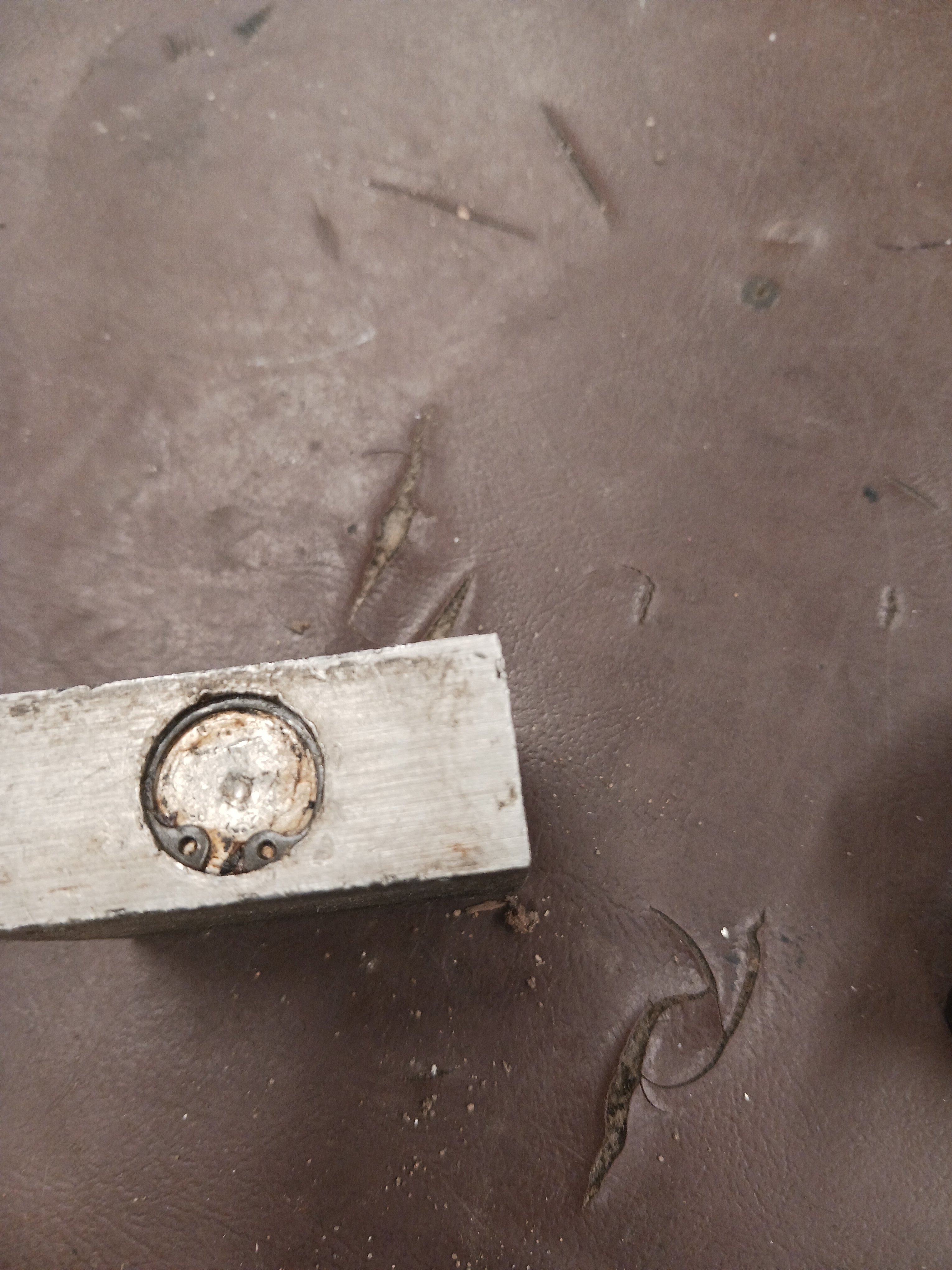

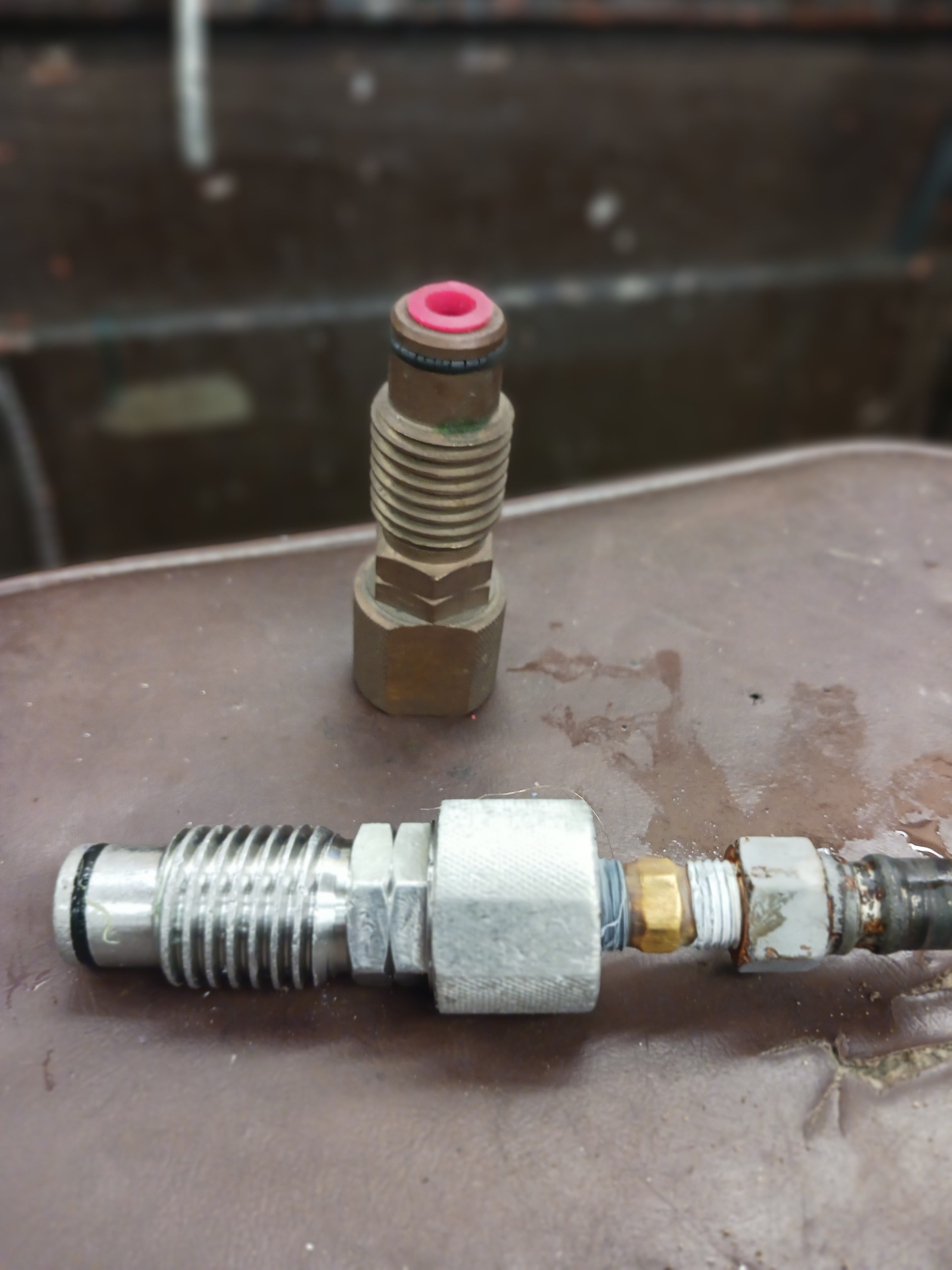

Another tool i came up with was a plug and jet tester if you took the star off for storage , you screwed this inn to keep crap out back end taped 1/4 20 ror quick connect front 1/8 female pipe was so you could clean clogged jets or use as a cleaning sprayer.the first picture is the machinest's interpretation of my idea we called it the "dick " picture #2 is what i had pictured in my mind, but was too expensive to manufacture even made a couple out of nylon. Picture #3was my favorite design and I still use the stainless one (only one made double lead thread)still too expensive to manufacture, bottom hex shape one was the design we could have manufactured using a stock hex material on a cnc machine,

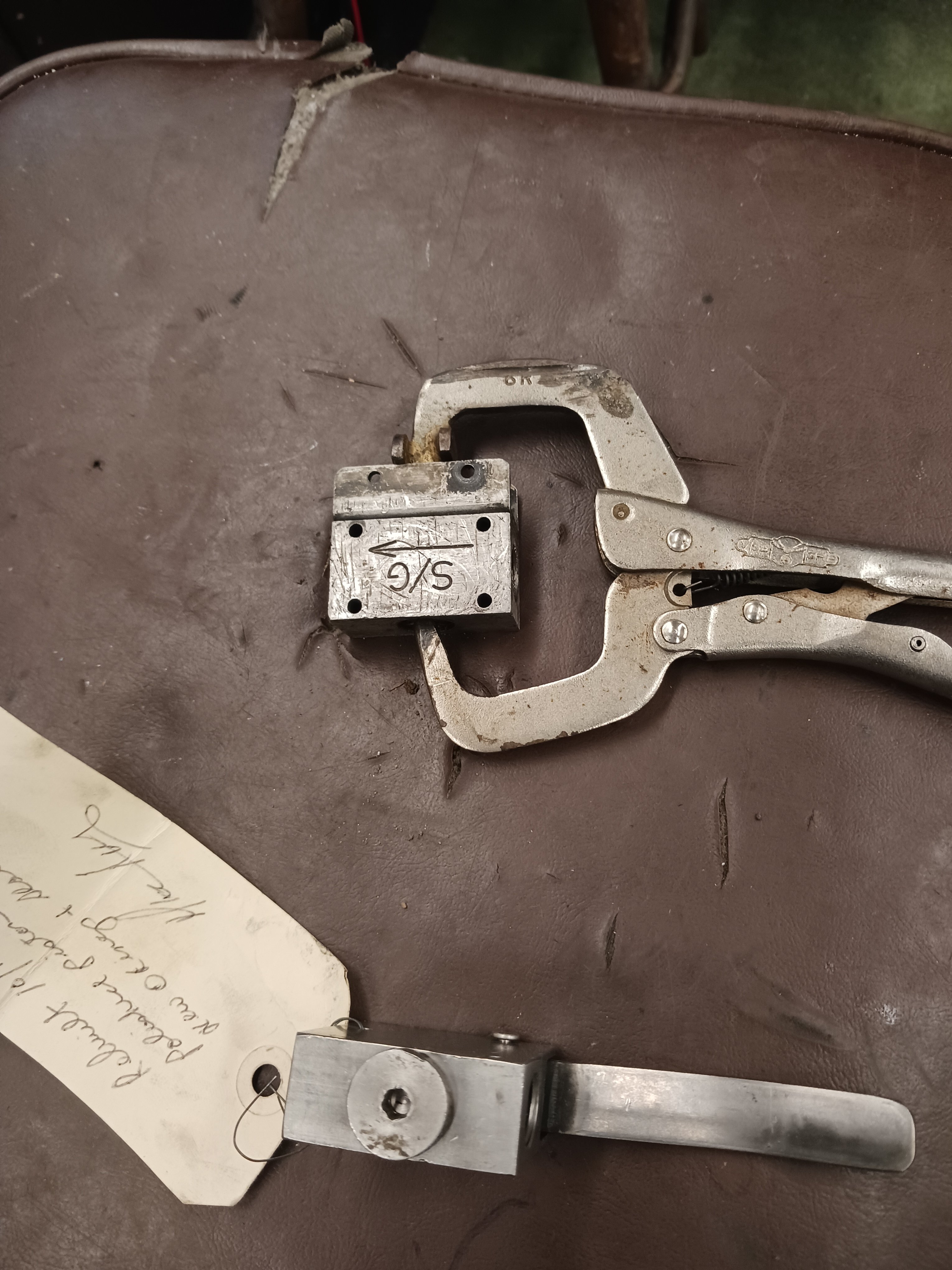

Ok but most of the things aside from the rx20's were built specifically to address problems with steamgenis , so with that in mind this one is for Bob, can you guess what i built this for? It solved a problem with servicing steamgenis in the early 90's and 2000s
Reactions: Giorgio
Dwain Ray
Jul 22, 2020
344
View attachment 120078 View attachment 120079

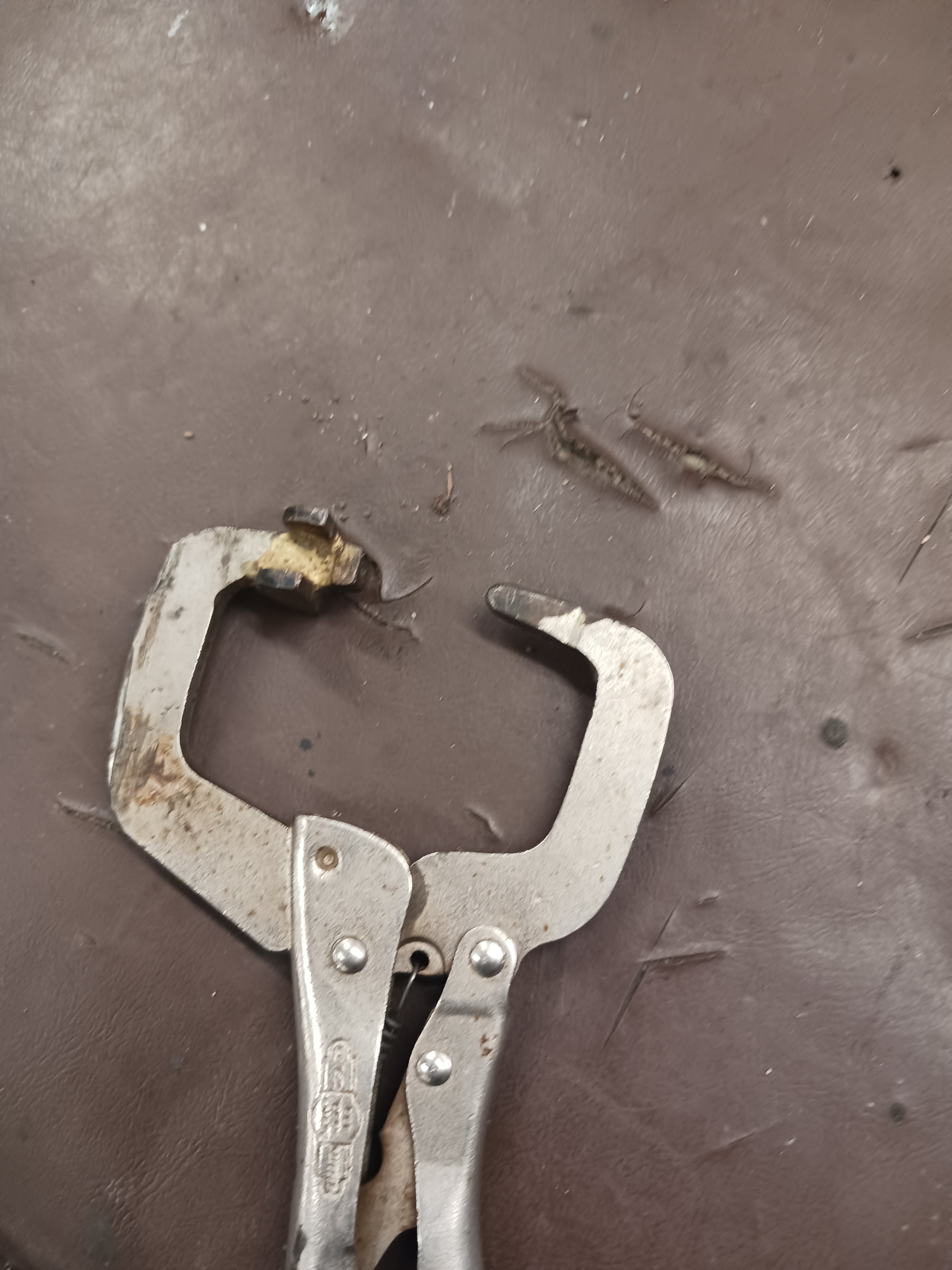

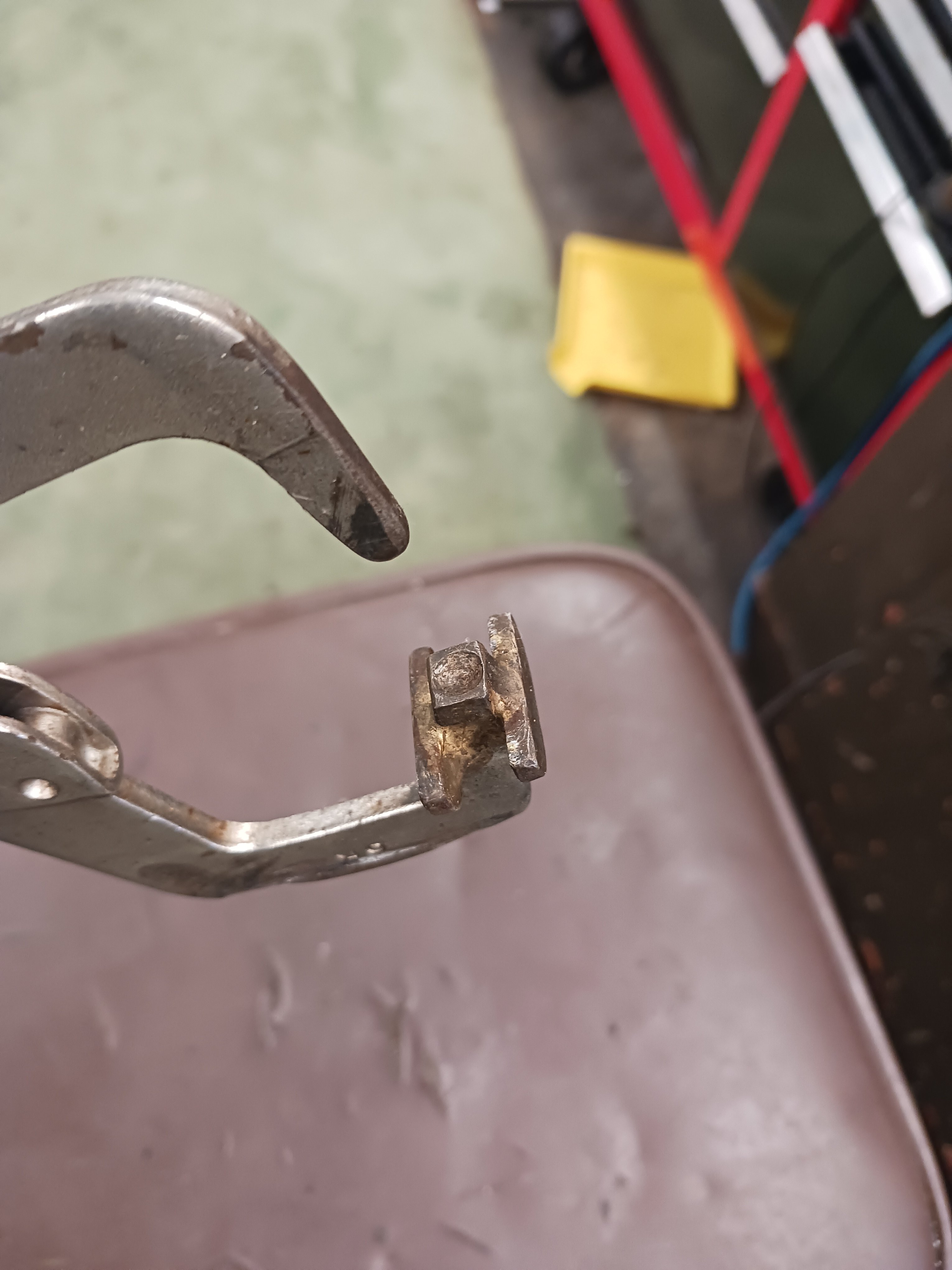

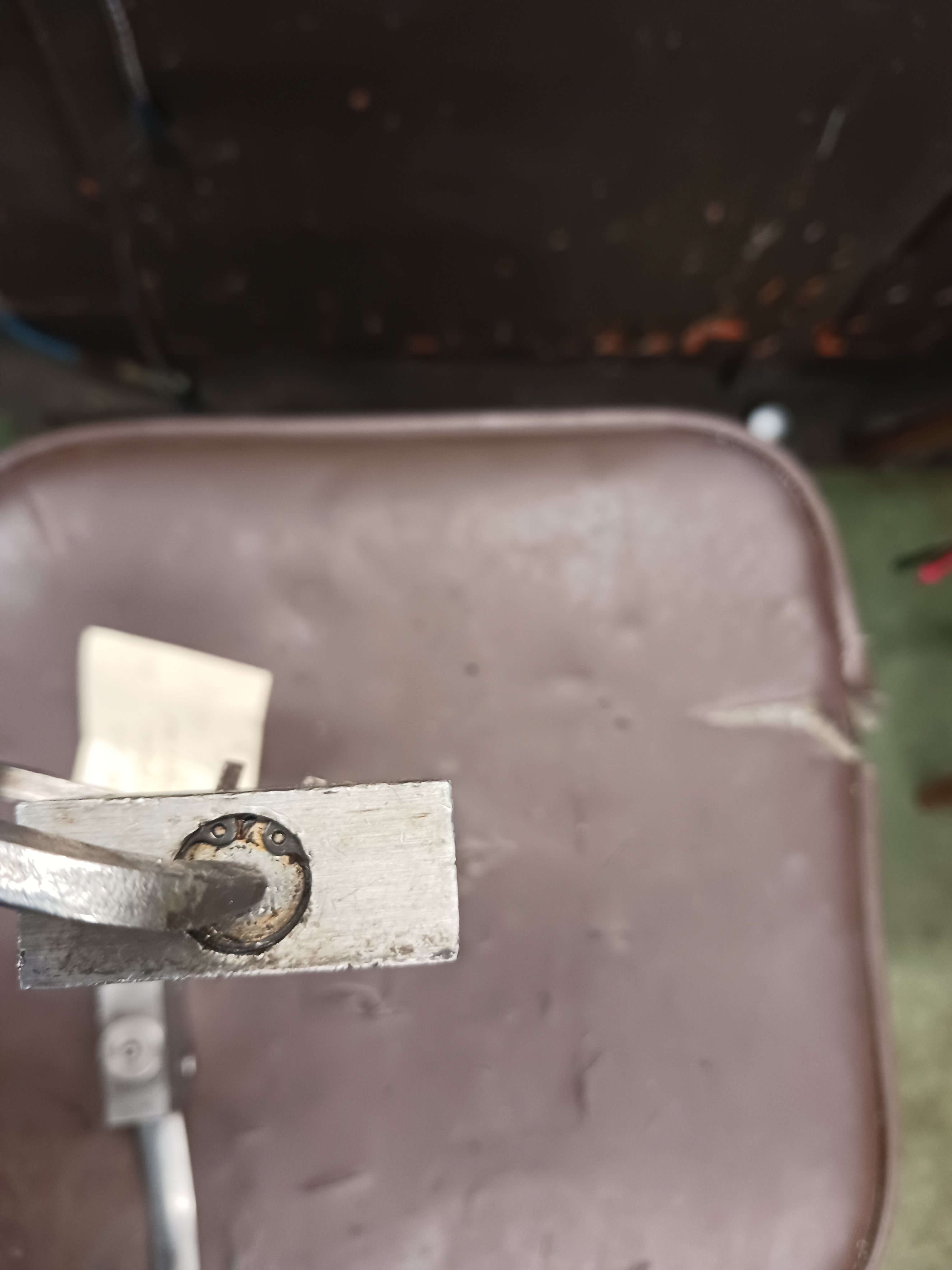

Nobody seems to be interested , but this is a steamgeni valve repair tool . Makes it easy to rove and install C clip

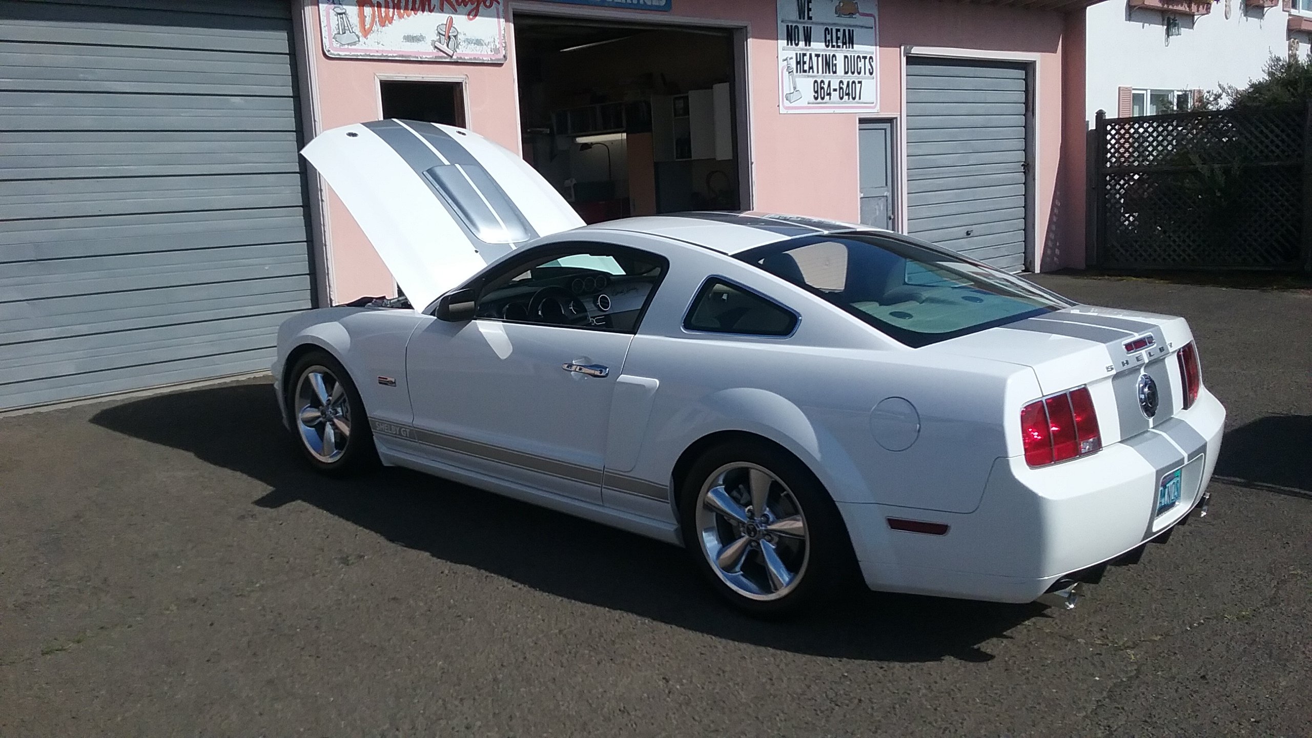

Got any pics of that? It might be fun to guess the year.

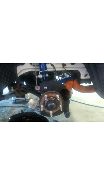

If you tap on the picture of the front hub (1st picture its a gif file showing the 10,000 suspension up grade i did

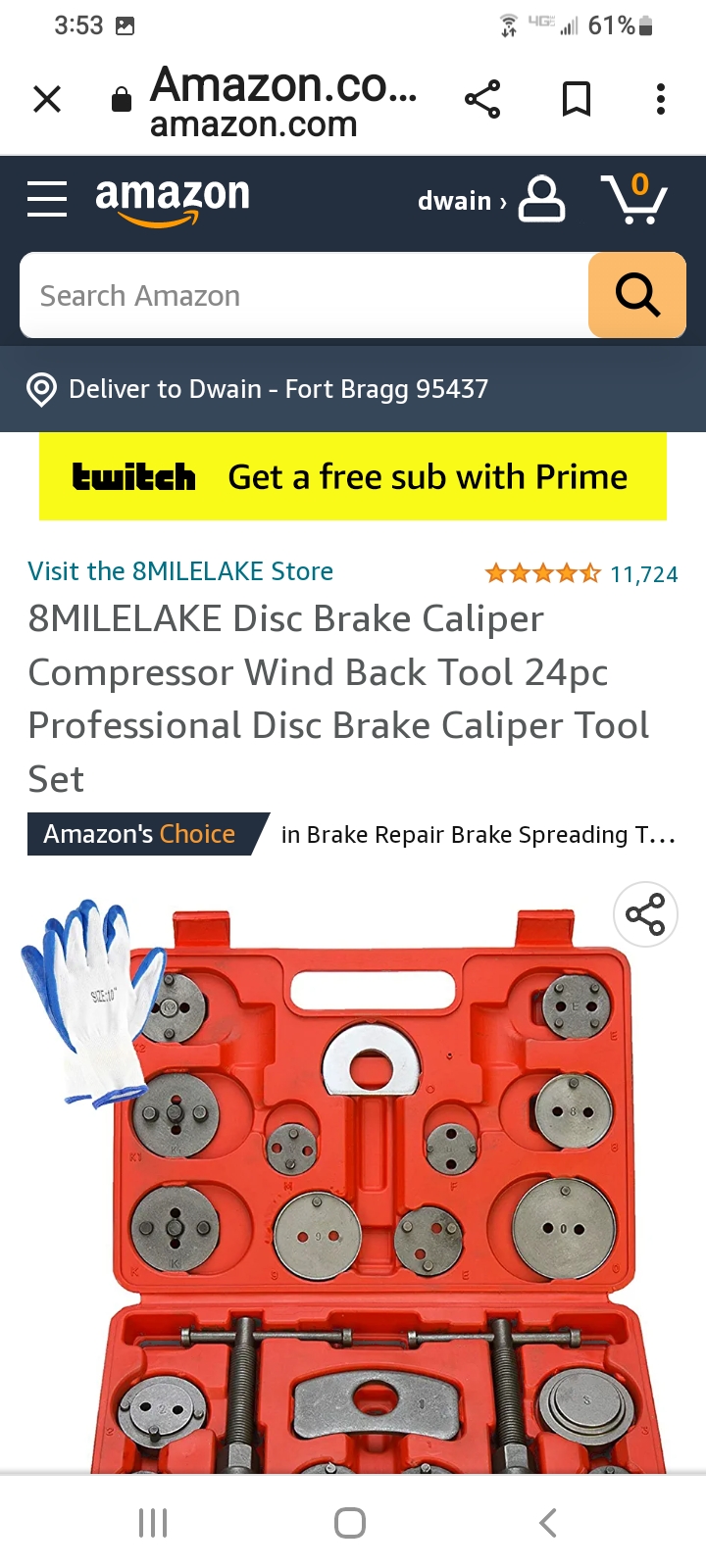

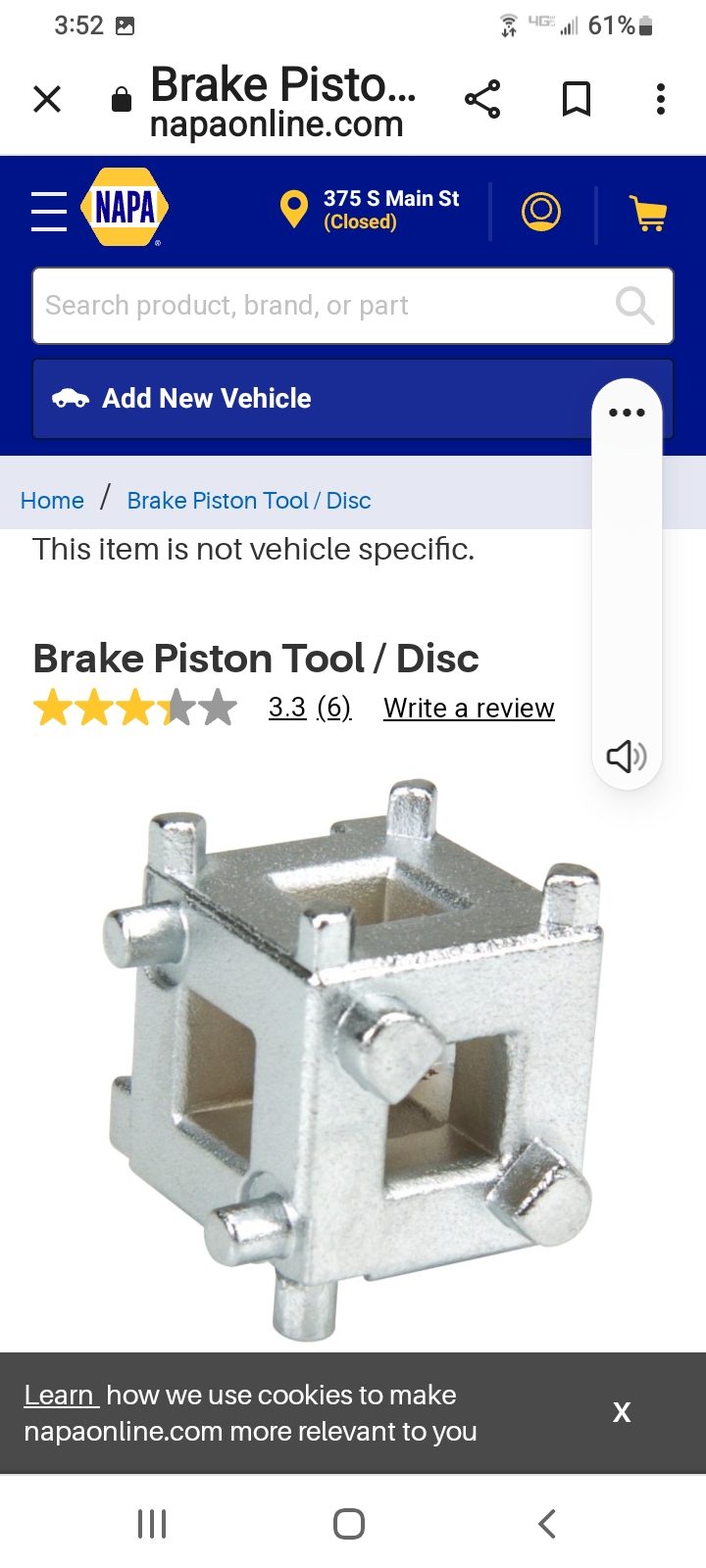

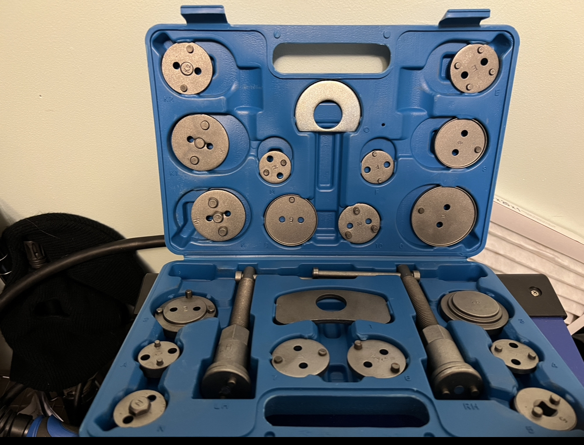

No problem, you'll need 1 of these, i used the cube on the mustang but it's a pain in the ass to use i bought the set (like 1 pictured) from harbor freight shortly after
View attachment 120198 View attachment 120199 View attachment 120200
I figured everyone replaced the SG valve with a different one
I did
I started in '90 with a Hydro-Genie and drag wand.
That valve was ridiculously expensive to a starving BDCC (broke dik carpet cleaner)
I cut and drilled the drag wand handle an fit a PMF valve in it
