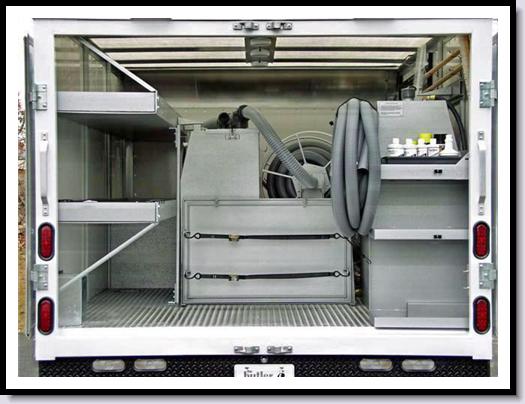

Still not enough room IMO

That truck is just what I have been waiting for.
Seriously!
Now, that doesn't mean I'm going to purchase one anytime soon, but when the time comes for my next purchase, I think that will be it.
Assuming the owner reports are good at that time.

LOL ... no, but I WILL wait until they have a larger blower option. I want to be able to dual wand.

Mikey,
Here is your chance to design the ultimate Truck Mount.
Name any Blower,Pump,Engine,Truck,Body and configuration.
Performance ,Dual Wands,Pressure,Vacuum,Noise,Hose size,Reels,Wands,
Vac Tanks FW Tanks,ETC:
Put a price on it.
Thanks,Judson

To really give V/AT a run for the money, they would have to step up the POWER!
220 degrees and a 4007 blower is not even in the same league as the Big trucks.

Ok.
Take a Ford LCF with the 6 cylinder. V sized box is perfect for my area. Rear step needs to be 2" higher though. Roll top door in back.
Use a 6008 series with a dual splash, a Cat 5CP Blue Line Hose real with a divider-flange that splits the reel so 2/'3rds holds 2.5 and 1/3 2".
Use the round V waste tank with a APO that wont clog. Three 2.5 ports to filter box that restricts as little as possible (if possible)
Use the round AT fresh tank but sit it upright next to the waste tank, side by side for more floor space.
Either BL's or AT's HX system. If BL hasn't figured out how to fix the leaks then go with AT's.
Lots of racks on the ceiling for wands, rakes, tile tools etc.
Use enough silencers so I can clean at night next door to Mrs Kravits.
3 pressure/garden reels too..
How about 60 grand?
