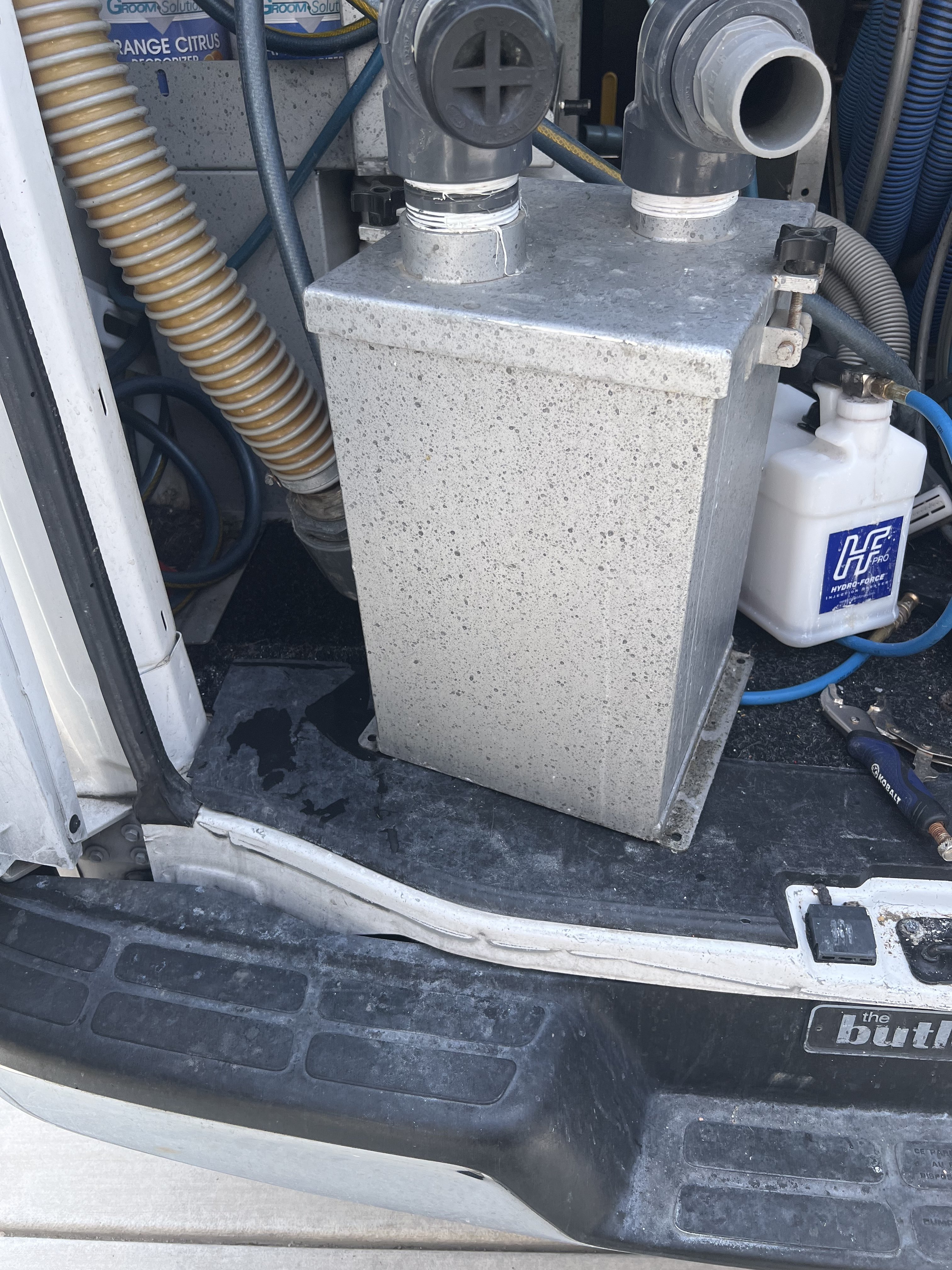

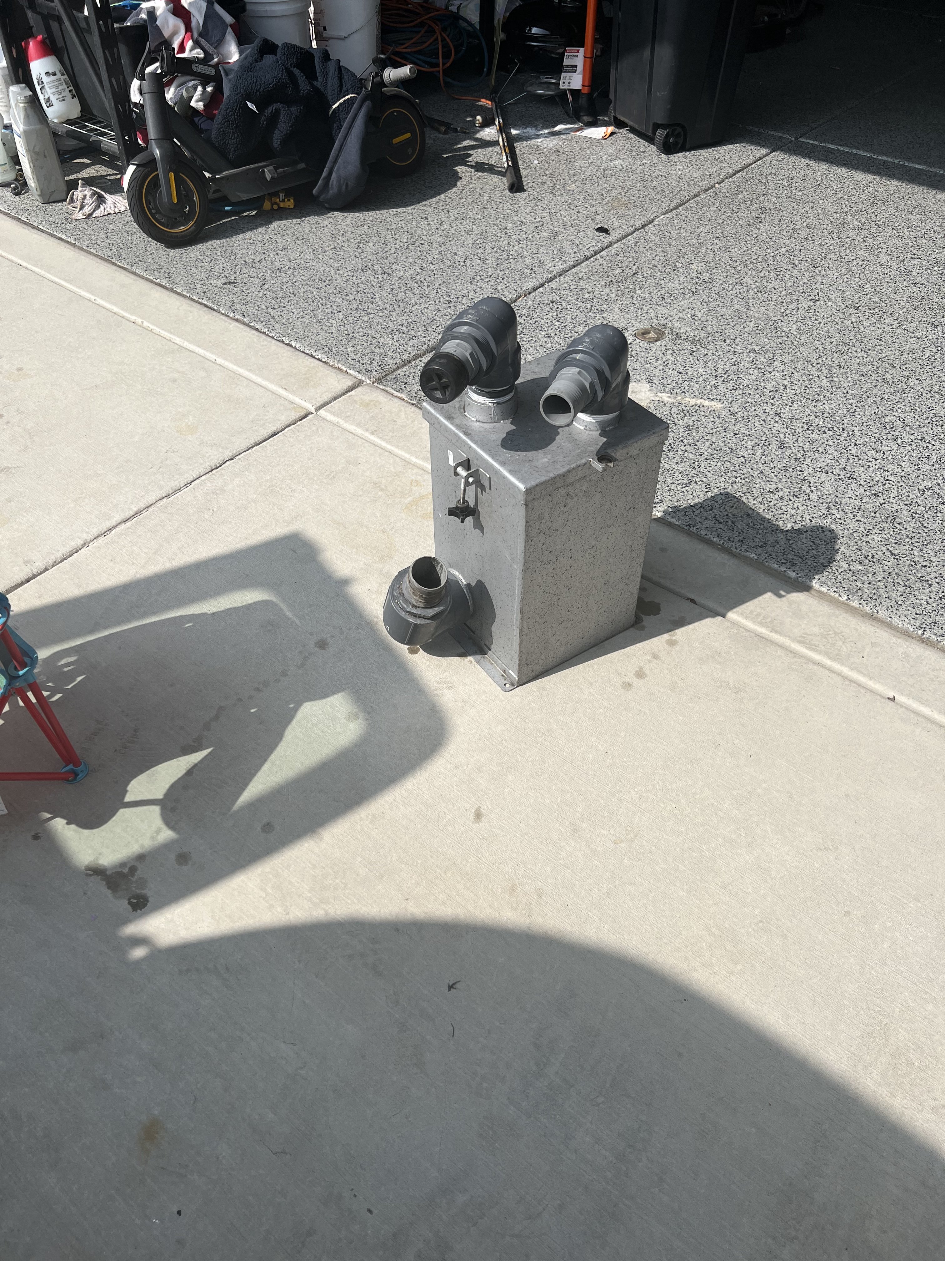

I bought a butler and so far has been great but on large jobs my tech is telling me the filter box is filling with water and he is loosing suction? I’m gonna be working on it tonight any help would be great!

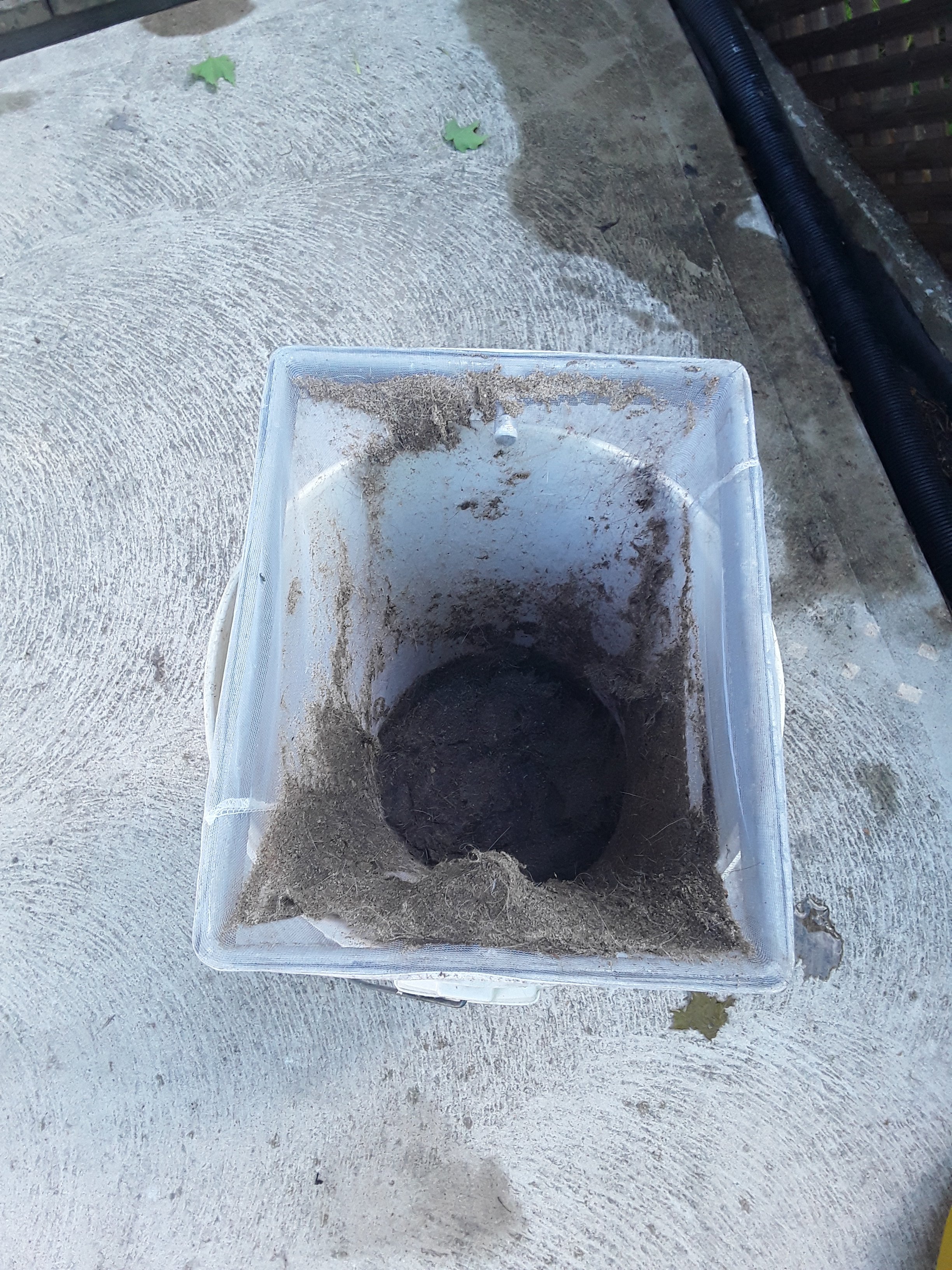

Well the clog was in between my employees ears he was removing the sock filter and emptying it but not spraying it out… it was covered in dirt and sand and couldn’t breathe I took out the box and cleaned everything out and showed him what to do…

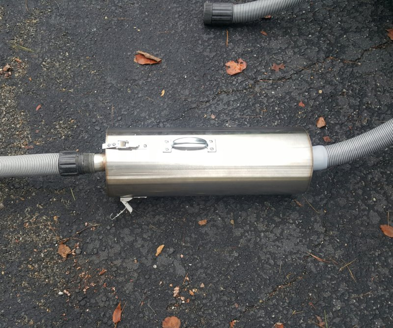

i'm talking about one of these, Jay

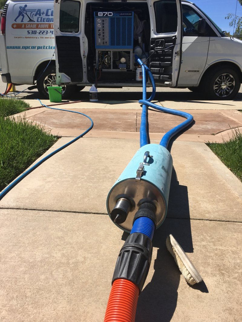

your van looks constipated lol how did you get that beast in there... I have that same setup in a box van. I like how the butler one is setup because its easier to use the filter if I give them a devastator they wont use it because it will be easier not to. I am gonna order a reusable one through butler.
on the 870 do you think the 2x 2inch setup is better than just running 1x2.5 to the filter?
DAT
Apr 3, 2017
6,486
Nevada
Bill Cheryl
Not his, that's @Nomad74 truck..

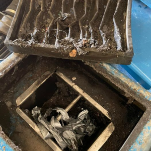

I had the Devestator and sold it because of the pooling of sludge water that always seemed to leak from it.
This is my in-tank filter that fits into the top of my waste tank. You can see the aluminium frame that the paint filter attaches to. All kinds of breathing room for the blower with this set up.
The filter can be washed down mid job if needed.
Leaking like after a job and you pick it up?
Or the filter so full some spooges out the front hole?
I like mine because it keeps said spooge out of truck....
