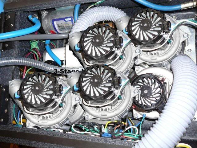

After testing several vac combinations over the last month . . . .,
we just finished building a new 3-Vac Hi-Lift Breeze Extractor.
It has 2" plumbing throughout the machine
and three new Hi-AirWatt Vacs:
Breeze Extractor Sealed suction is 201" (~14.9" hg)
It develops 131 CFM.
It has two hi-lift vacs in parallel,
feeding into a high CFM vac motor in series.
Pump system is 500 PSI with 1.4 GPM flow.
It is the strongest commercial portable extractor that we have ever built.

Cool Larry.... How long has it been out running? How's the heat from the vac motors in the compartment? I've heard that heat from the vac motors are one of the biggest concerns for failing motors....

Nate;
We have had other 3 Vac Breeze extractors out for a year.
This model uses a new motor configuration for better water recovery.
We have a 115 CFM ball bearing fan cooling the motor compartment.
Most vac motors fail from moisture in the bearings.
Larry

Thanks for the clarifacation Larry... I assume it's a 1 stack or tube in the recovery tank? (Sorry, brainfart, can't seem to think of what it's called)...

Nate;
It is one 2" standpipe in the recovery tank.
Mytee has a grill-type float assembly that provides very little restriction.
Larry
