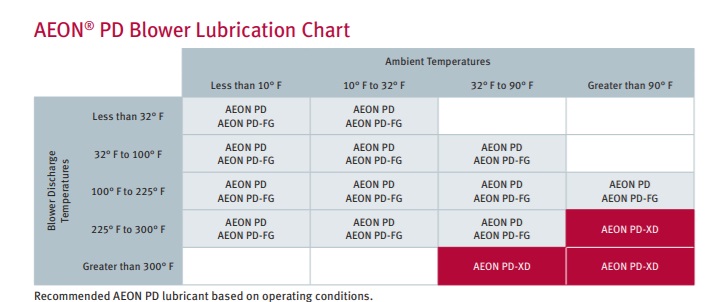

For me it is not about the cost. My machine takes care of me so I just want to make sure it get's the best from me. What is the difference between PD and PD-XD? Butler recommends the XD for their machines.

Where did you get the advice to try mobile for your Everest?
I used A.I. to cross reference it. The Mobil is actually a superior lubricant with a broader temp range and all the qualities that Aeon has, like anti-foam properties.
I run Rotella T4 HD diesel oil in my motorbike based on the advice of thousands of online cheapskates
I'm not a cheapskate by any means. I just believe that there's better options.

FWIW, I was informed that in the winter, a guy should run lower viscosity, and in the summer, a higher one.
I guess it depends on hrs put in, and ambient air temperature.
Makes sense.
