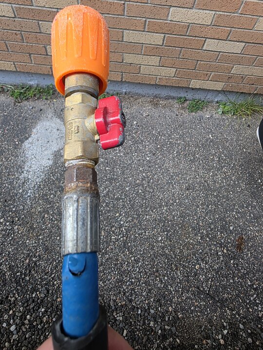

What is the best solution line these days? I'm not worried about cost. I just want something with the least amount of memory, doesn't bleed on the carpet, and can take high heat.
Friday I was doing a post construction clean at a historical building that was being remodeled and my line blew right at my QC on/off valve. I'm glad I wasn't using high heat because it sprayed me right in the face, which was still actually pretty dang hot.

I see ya got a wanders valve on that hose. My advice is, STAY AWAY FROM THEIR HOSES!!! Goodyear neptune 3000 has been my go to for decades

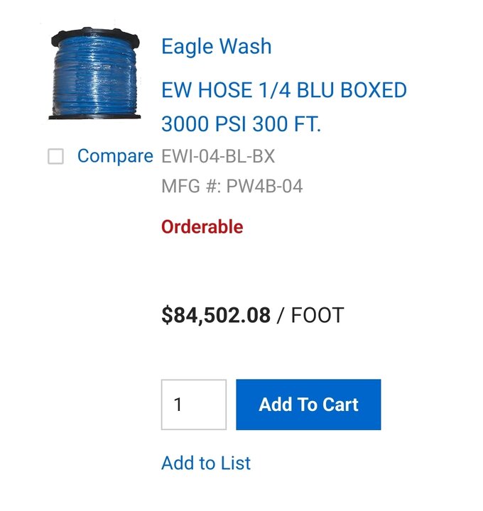

Bryce
I just learned mine is made by Eagle Wash. Wow, this thing really must be the best solution hose ever. It's over $80k/foot 🫨 I'll need to pull out a loan when it's time to replace it.
