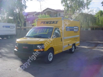

here are a few pic of the van like I am talking about
http://www.morgancorp.com/products/parc ... allery.asp
the pics only show the 10ft long model, the 12ft model would be the ticket, put in the cab access door, allowing you to mount the truckmount nearly full forward and still have access to work on that side of the machine via the cab access door, the extra length in the rear should also allow you to mount your reels behind the wheel wells just fine. someone should really market these type van to the CC world, they sure would work alot better than a plain ole extended van. the only thing haven't been able to find is a place that sells these type vans new.

adam that van is the shiznizzle, is that the 10 or 12ft model?? where do you guys buy these things new at?? roll up doors is definatly the way to go, even on the side door if you can get that, because you can park closer to things and still be able to swing the doors open, plus with roll up you don't have to worry about it flapping in the wind.
