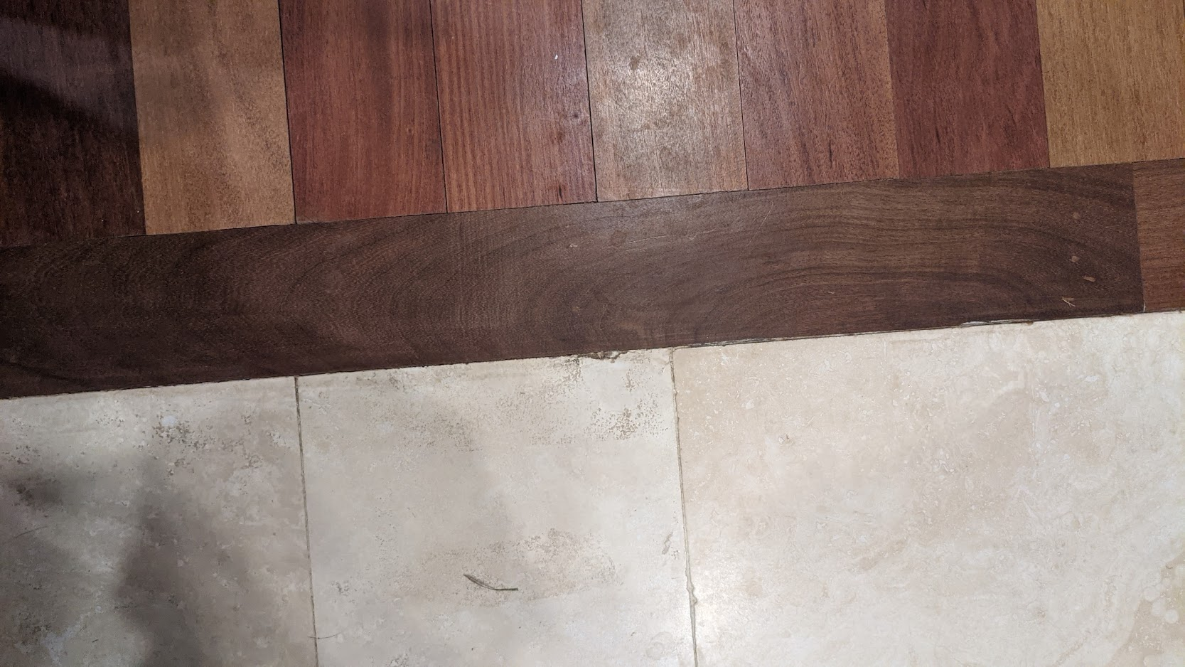

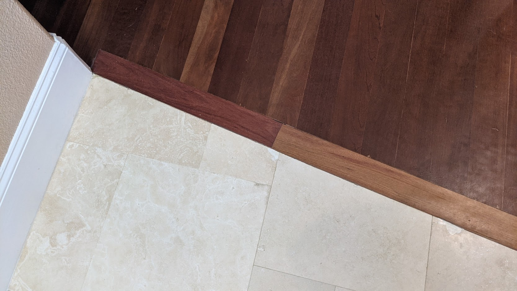

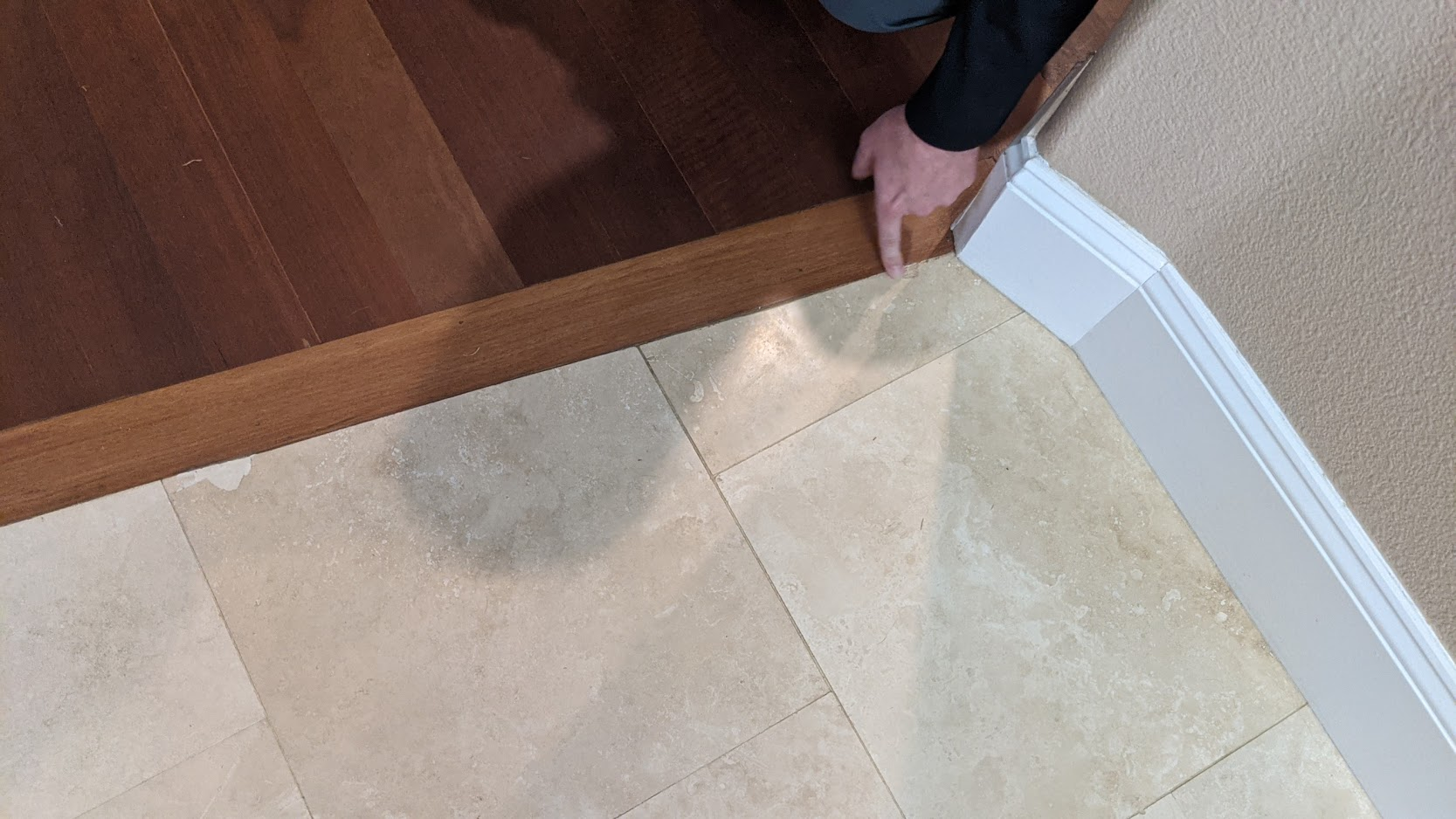

Any suggestions for this transition area?
117,305
Client is not happy with how the travertine and the wood join. The 1/16th gap is filled with some wood putty and some grout happ-hazzardly. The edge of the Travertine is rough and some fill has popped. It sits higher as well.
I know, 1st world problems... but they want it smooth and pretty..
T molding would look goofy ..
Is removing that boarder strip of wood and an equal amount of tile and inserting a 6" wide stone slab be possible, after the fact?

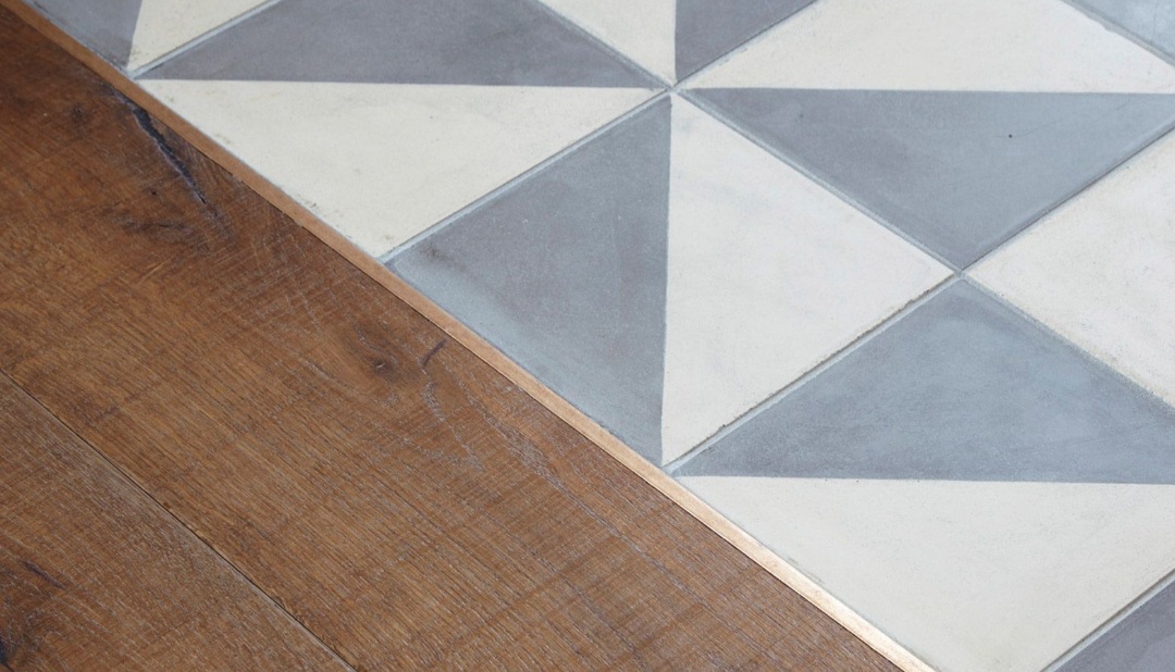

or use the schluter trim like mentioned earlier, typically it’s installed under tile but you could install under the wood portion.
Those schluter edges are very nice.
