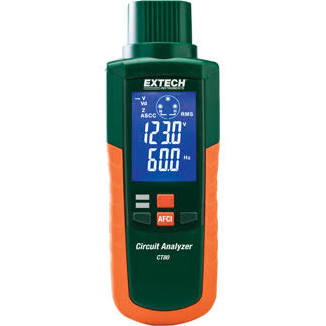

There are some new meters that check the capacity of a circuit by applying a brief current load and looking at the voltage drop.
We like this model ( $249) : circuittest.jpg

That is a nice instrument, but it still doesn't tell you the load that is currently on the circuit. It will impose it's own load on the circuit to measure impedance and voltage drop, neither of which answers the OP's question...
