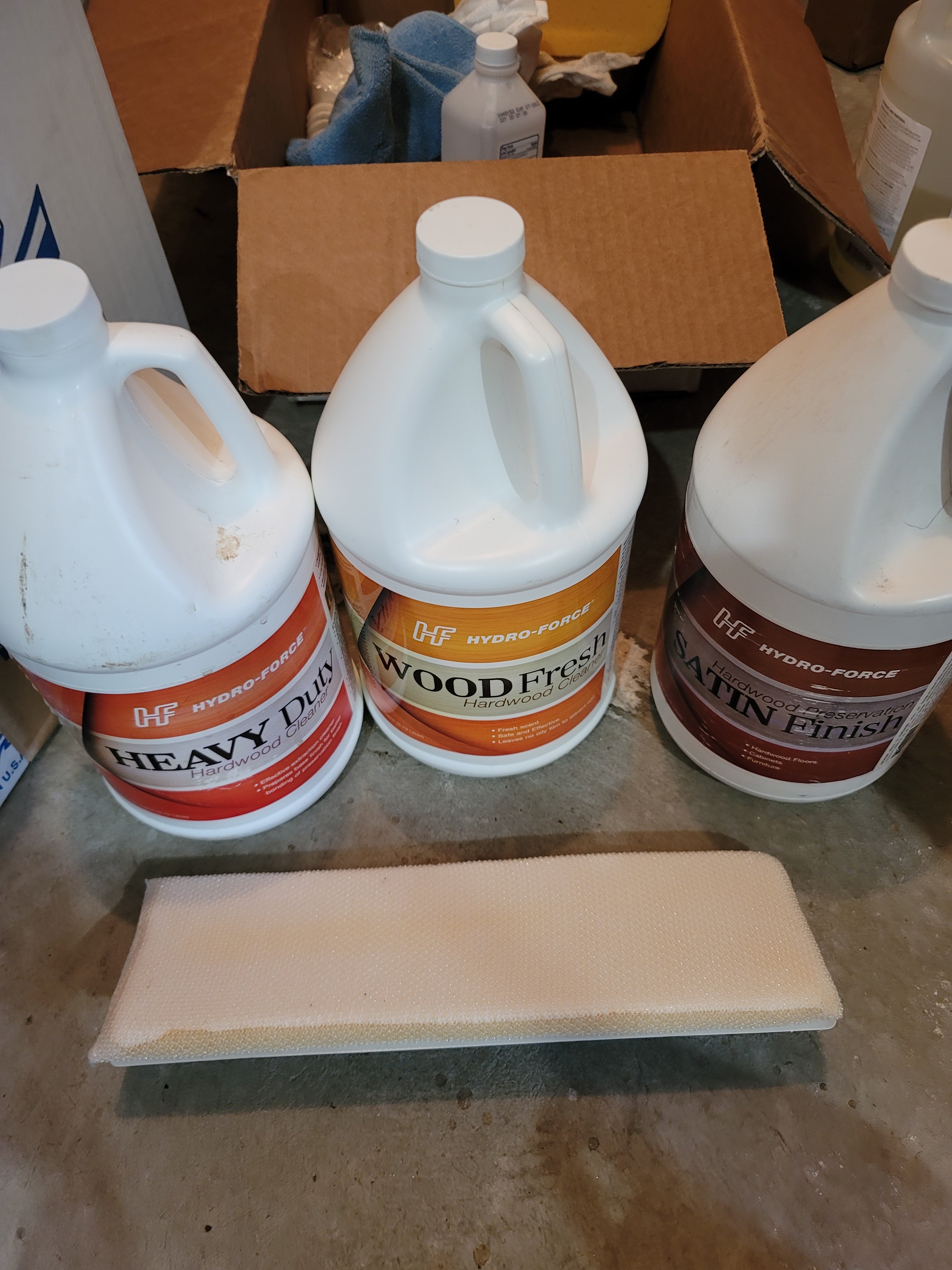

Is it Engineered or real hardwood? Any pics? I've removed paint with Contec scrub pad and Hydroforce Heavy Duty Cleaner. Also sometimes a little dish soap and water can be all you need with a scrub pad.
