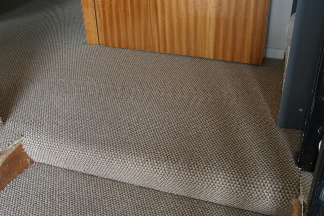

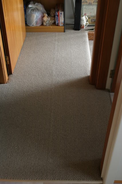

Here's the deal. The client bought her whole house lot of carpet. The estimator had drawn the plan incorrectly so when the layer 'shop cut' the roll, he had a huge gap in the entrance way that he had to fill with a seam going both directions. The cross seam really stood out.
The layer finally agreed to replace the entrance/hallway complete as one single piece... only when they ordered the replacement roll, they had to settle for a different dye batch and were told thats the end of that line... no more available carpet of that type.
Whan he installed it, this is what they found. A tension issue running the complete length of the roll (approx 8 meters).
So, Feltex have sent me in with the task of finding a solution. I met onsite with both clients and the layer. THe layer had NO suggestions whatsoever and I felt he was out of his depth.
I siad I have a few options, but want to discuss with the Feltex rep, them, you guys etc before we settle on a decision.
We found a small off cut of the ridge and I brought that back with me for testing.
There is enough carpet to cut out the offending piece and put a seam in the opening but they are reluctant to do that.
Second option is for me to re tuft that ridge... no option because of how much there is I reckon.
third option which is where I'm out of my depth is "is this croppable?
That section you can see is 2-2.5 m long. There is another section in front of a hallway cupboard which isn't really noticable because it has no back lighting.
I think it's just the cream that is too high, but that could well be just because that's what's catching the light. It's 3 rows wide.
Oh yeah, the job is three hours away.
ANy suggestions from you guys?

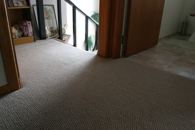

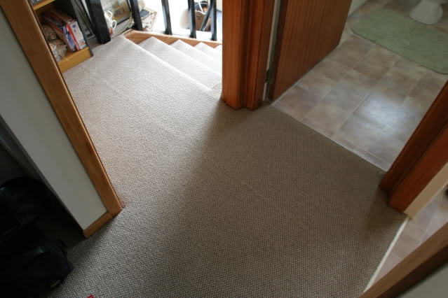

After looking at the photo again...Even though this is not the same "dye-lot"...
The color is certainly within the 20% standard that the mills adhere to.
The "AESTHETIC" problem here is the LOCATION of the seam...!!!!!
As the Installer KNOWS..you cut-it..you own-it..."NEVER trust an estimaters LAY-OUT"
It appears that the seam is "PEEKING"...More noticable because of the lighting...
These good's...Installed in ANOTHER room...would be hardly noticed...
There is possibly another SOLUTION.??? Offer to install wood or lamanate in the hall &
bathroom... :idea: This would be an UP-GRADE to the cleint...&...a solution to the
offensive PROBLEM AREA... :!:

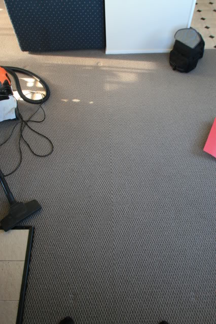

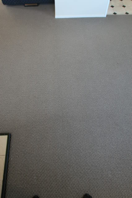

Joe, here's a couple of photos of a join I had to correct, different product, but still a patterned loop pile product that shows the necessity of pattern matching. With the correct tools and procedure, there should be no peaking and I believe I should be able to get a tight join. Maybe I might have to eat my words, but I do feel confident at this stage. I have the off cut so I may just do a test join before I go out. It is not an off set cam shift style carpet. The lines are stright so shouldn't be a problem if that's what you were referring to.
John Middleton said:
Problem join with pattern mis match and peaking.
Rectified.
