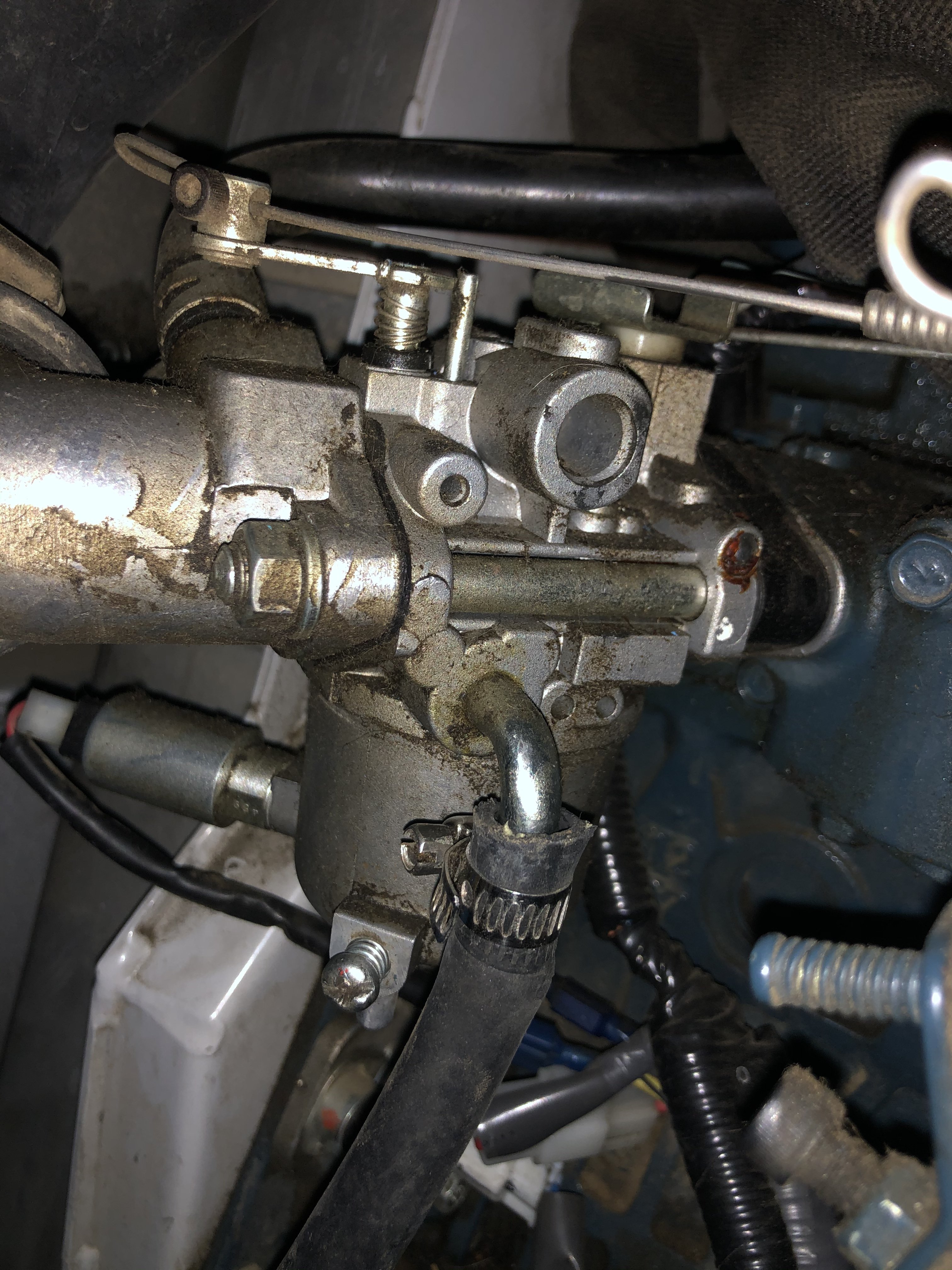

Ok here’s the situation, I have random shut offs runs and dies. Changed fuel pump and and a fuel line fuel filter.
Bypassed the float switch, got great fuel flow out the hose, but where fuel hose connects, there’s a screw on the gas cup that will let you see fuel flow.
well the fuel flow a lot out the hose direct but when I open the screw it flows slowly.

I guess it feels like the pot where the gas connect great flow out of the hose but barely any gas after that.

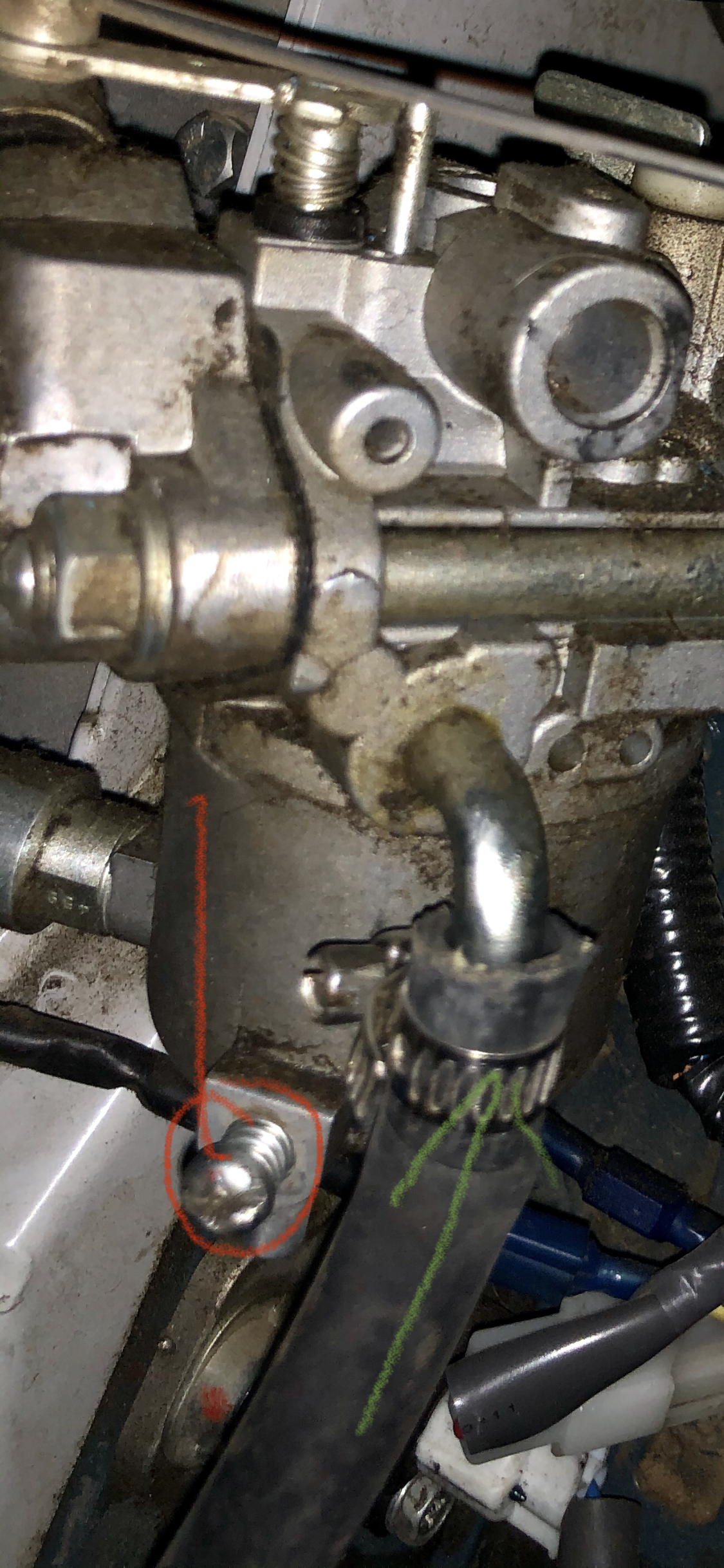

I pull the hose off green arrow here and gas is flowing great.
I open the screw red arrow, and gas use to flow out the bottom great. It trickles so I believe there’s possible blockage.
When I replaced the fuel pump the out bound port popped off, but I glued it back on and there’s no leaks,

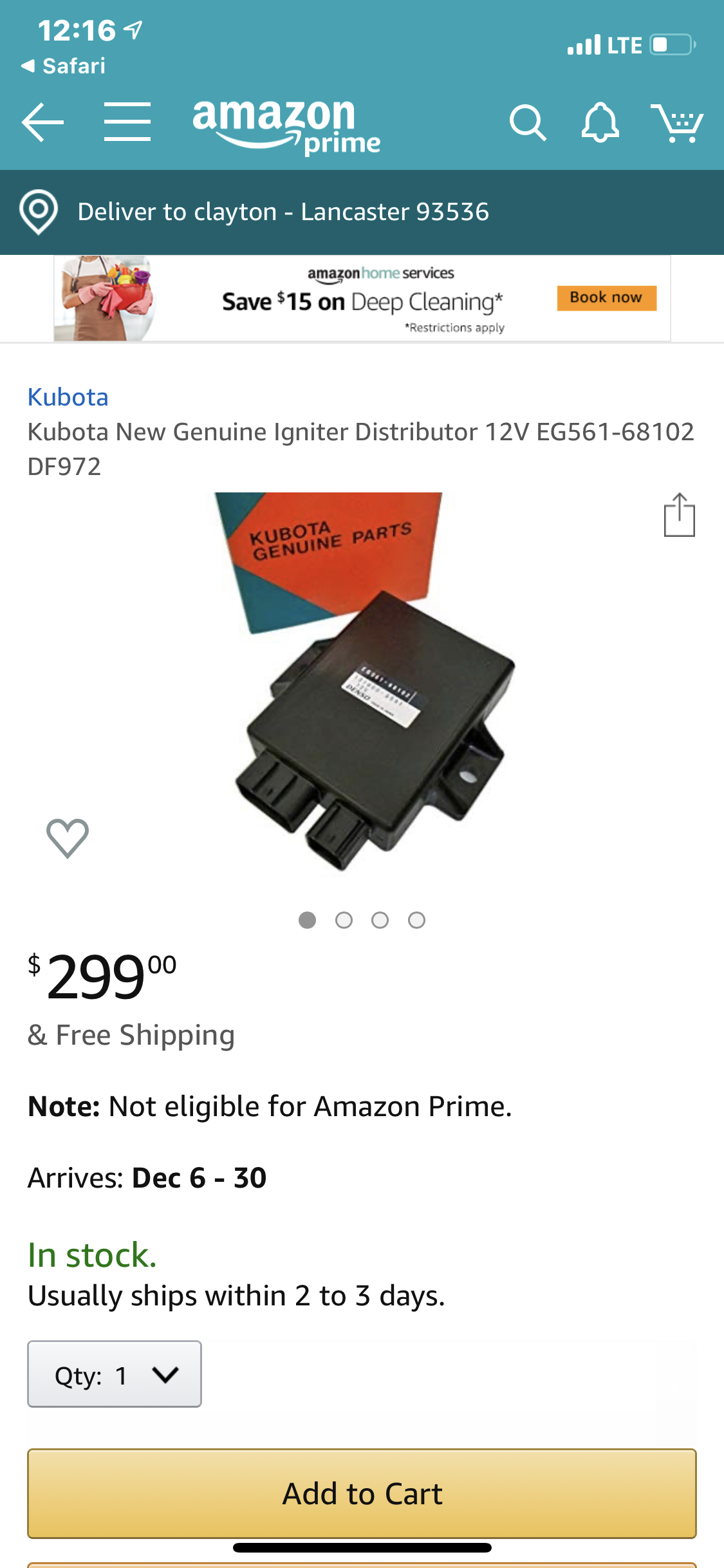

Bad relay switch, hope this keeps running for awhile.

It doesn't matter to you now since you already know it's not a fuel related problem but the reason why the gas just trickled out the open screw is the volume is greatly reduced through the float valve.
Yeah I figured that out. I don’t know why I thought it was coming out faster at one point!
Still I wasn’t going to ever figures out a bad relay!
