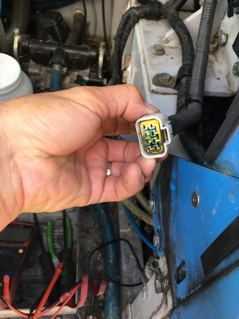

So I posted on Facebook a video with my 570 sounding like a lawn mower.
Ended up being the computer controller and computer harness assembly.
Procyon as a rinse in the jug and for some reason my guy is getting it every where.
The brass pins were completely dissolved.
Ended up replacing the ignition coil to.
And overnight shipping cost about 1k
Oh well.
I bought the pro 1200 for the guys it's time I switch back to the 570 and take care of it. I owe 2 1/2 years on it then maybe I'll get me another pro1200se
