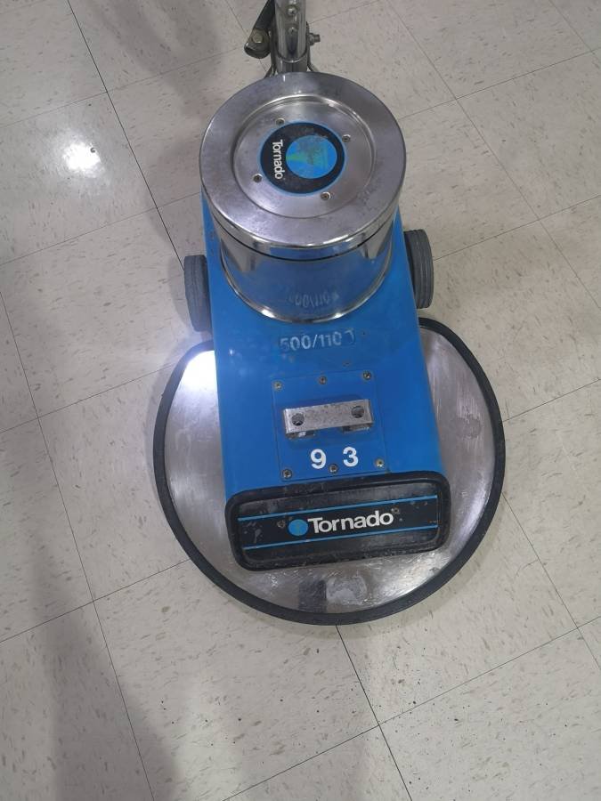

If you want the floor to gleam, this is your best friend. $475 on craigslist here.

I have that same tornado you posted above and its only 1500rpm max. Nothing to brag about
