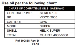

Jul 13, 2019 #5 Mikey P Administrator Joined Oct 6, 2006 Messages 116,402 Location The High Chapperal Reactions: Cleanworks and Wade A
Jul 13, 2019 #6 W Wade A Member Joined May 15, 2019 Messages 40 Location Delaware Name Wade Mikey P said: View attachment 92179 Click to expand... Thanks Mikey
Jul 13, 2019 #7 BIG WOOD The Timminator Joined Feb 4, 2016 Messages 14,255 Location Georgia Name Matt w. I bet the manual says 15w40 just like mine did on my Titan. I used 15w40 for over 500 hrs with no problem Reactions: Wade A
