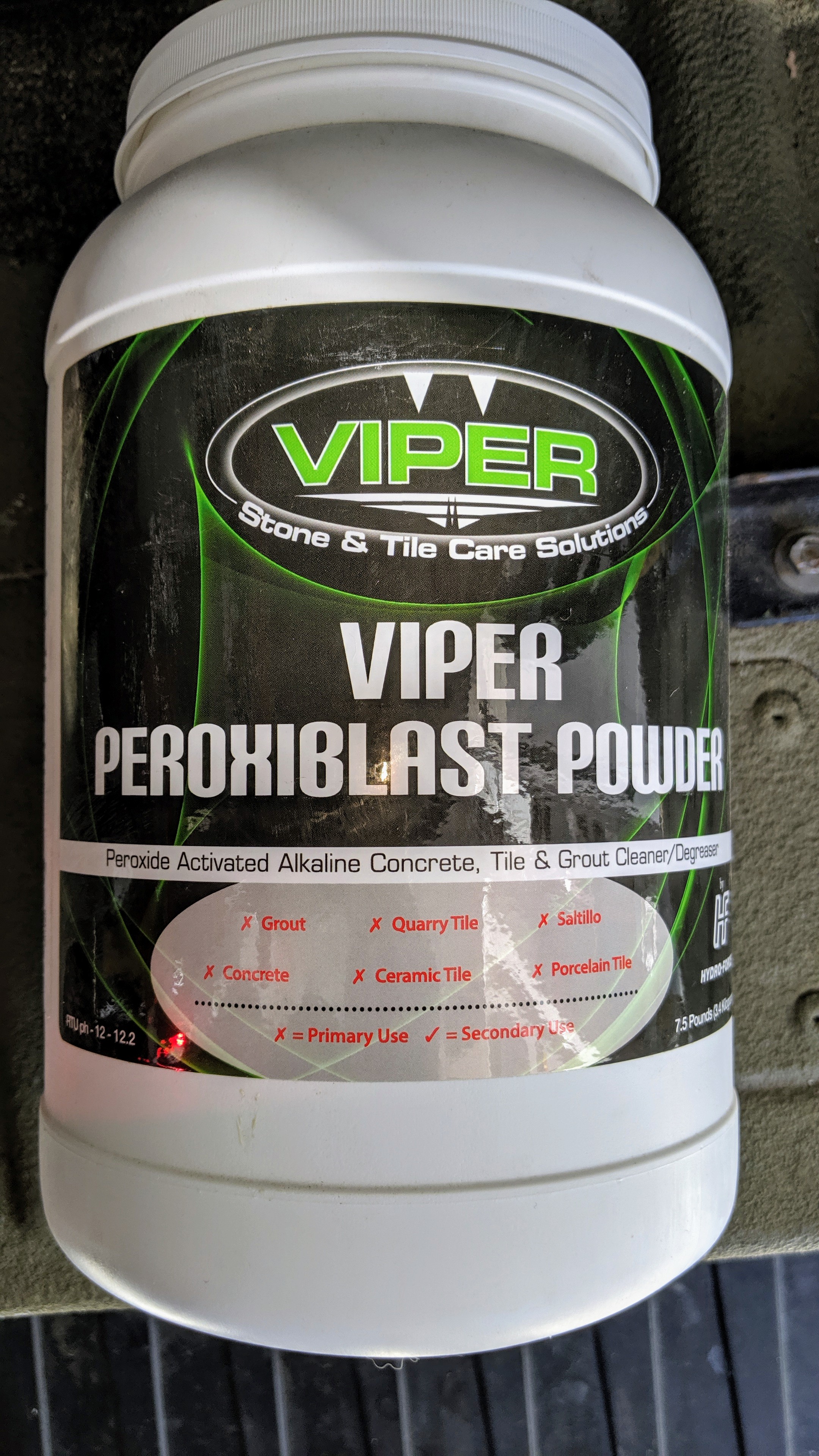

Do you have a powder that you use?
Name of product if you don't mind.

Viper Peroxiblast as Mike showed. Most powders with sodium percarbonate added use a small amount. We use at a level so that it is equal to adding 1 ounce of Boost All to a ready to use gallon. We also have Viper Venom Powder and I have heard of a lot of customers using Flex Powder on tile and grout.
